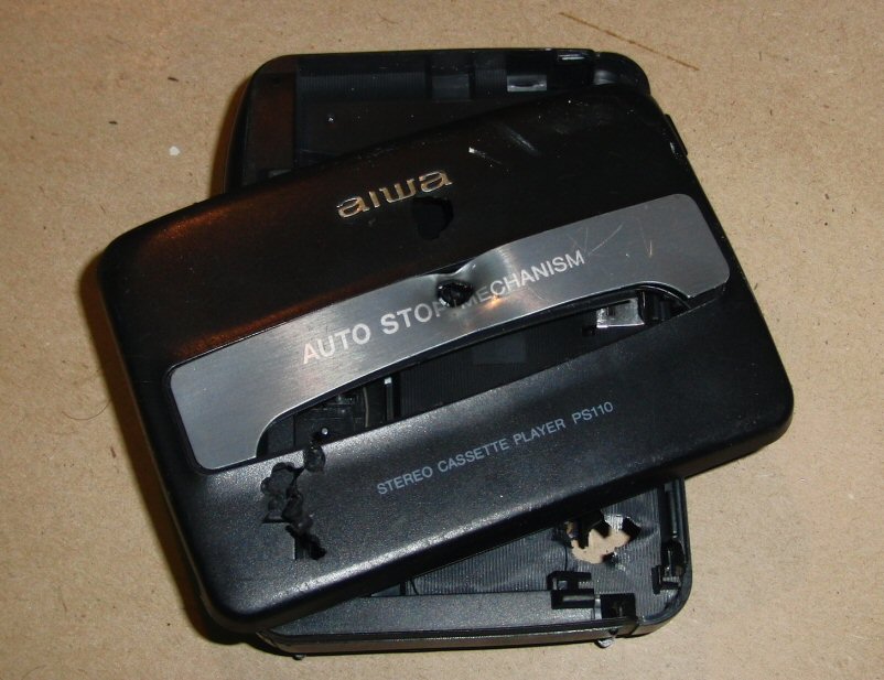

I was sifting through the debris littering the testing area, and noticed something about the walkman - it seems that the "auto stop mechanism" doesn't stop near supersonic lead pellets, someone should tell Aiwa :D
