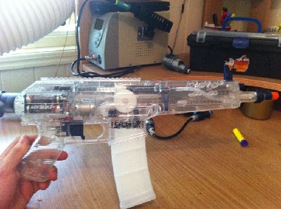

Saw these at Big W today.. So I bought one..$30

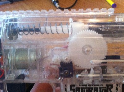

It has a lot of potential I think, the insides are very much like those of an AEG..
I'll probably put in a much stronger motor, run it off a lipo battery, put a bigger plunger and piston setup, and setup a T-feed mag for BB's..
If its successful I'll do a whole writeup and such.. But for now its open for you all to discuss and hurl ideas at me

Sure will.. I'd be happy if it had the same power as my nerf maverick that I converted to a BB gun. The biggest problem I can see so far, it the length of the draw back the stock gearing provides. It's probably about 1/2 the draw back the nerf gun takes to cock, so I'm sceptical that this will be a large enough volume.Will take some serious modding to get any decent power though
