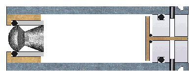

Having another go at this with a more precisely defined spark gap:

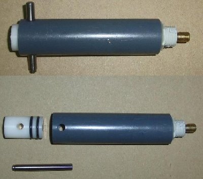

Another <s>blind stab at</s> work in progress on this idea following this discussion:
cartridge with endcap and fill valve/electrode, all that's left is the holes for the retaining pin in both the body and the endcap

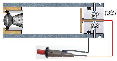

Some mixed results:
fill rig - win! - no leaks, cartridge held pressure beautifully. Still a bit fiddly but it can be refined.
ignition - fail! - click click click... and I think I know why, might have missed an obvious short point with the retaining pins...
Tue Sep 13, 2011 8:14 am
don't tell me there is a hole all the way through the plug...
if yes then FAIL :D

POLAND_SPUD wrote:don't tell me there is a hole all the way through the plug...
if yes then FAIL :D
There has to be, otherwise you can't push the pins in far enough to free the plug... going to try with some delrin plugs, which will probably shear if I'm lucky enough to get it to work :D

Here it is, closed and open. The schrader fitting is from my original fill rig, now permanently epoxied in place.
