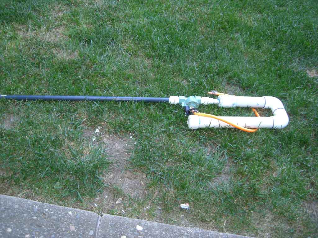

Theae are instructions to build a paintball cannon

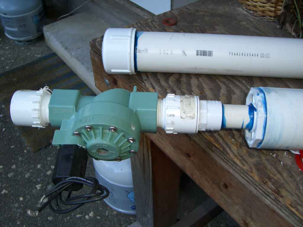

Now screw the valve onto the cannon using even more teflon
Using lots of teflon, thread them into the sprinkler valve

Youre cannon should now look like this.

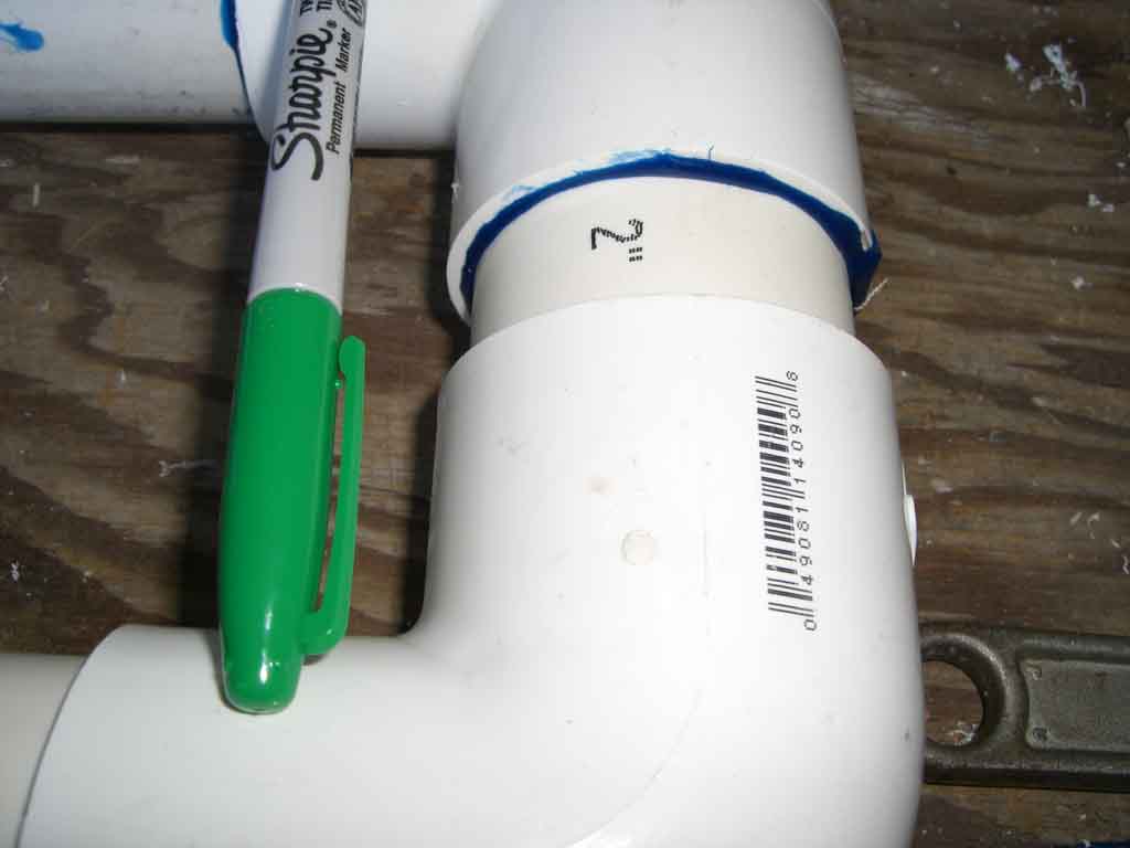

Now apply glue and line up youre marks

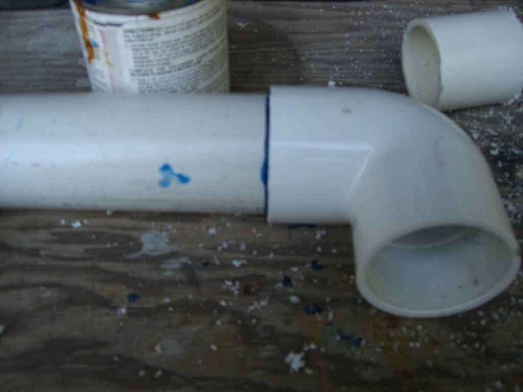

Glue a elbow onto the end of that pipe. with out glue lightly plue lightly push it onto the nipple out of the other elbow and mark the position with a sharpie.

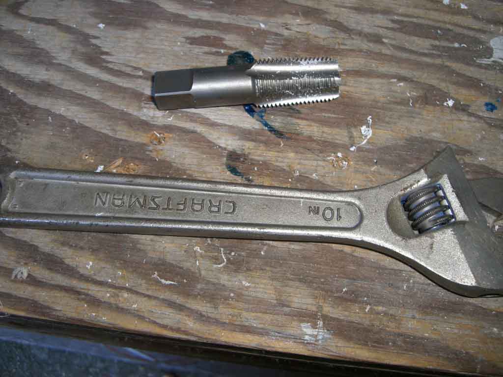

Using youre 1/2 inch tap, tap threads into the hole. go in one turn and out 1.4 turn then repeat

Glue the short piece of 2&amp;quot; into the elbow.
Glue the short piece of 2&quot; into the elbow.
Glue the elbow onto the end of the piece youre working on.

It looks almost exactly like my pb rifle but i used 1 1/2" for the stock. What kind of barrel did u use?
huse_spud
Posts: 269
Joined: Sat Apr 15, 2006 6:52 pm
Location: Center Junction, IA
Mon Aug 21, 2006 9:18 pm
lando250 wrote:It looks almost exactly like my pb rifle but i used 1 1/2" for the stock. What kind of barrel did u use?
i bet thats 3/4 sch 80

yeah thats what it looks like. You shoul use 3/4 cpvc for the barrel though because its the best fit.

nice job with the basic over under design. the only flaw i see is that it would take time to reload this sucker. an added breech would be really cool.
