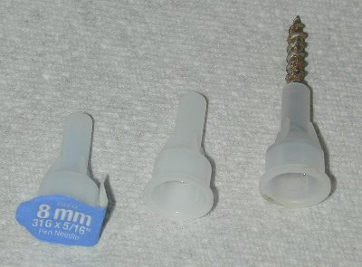

I am diabetic. I "shoot up pig dope", (insulin), every day.
I discovered recently, that the plastic 'protectors' on the hypo needles, fit perfectly inside a 1/2" pvc pipe.
The picture shows the needle container before use. The needle container after use, (and the needle has been thrown away) And the needle container made into a dart.
To make a dart of this, you simply make a small hole in the tip of it, then screw a drywall screw into it.
Longer darts fly straighter and more accurately. About a 3 inch screw is pretty close to optimum for accuracy. And for penetration of the target. Get too short, and they tend to just flop end over end. The shown dart is close to too short, and is not very accurate.
It is kind of the luck of the, (manufacturing), draw, whether it will be a loose fit, or a tight one in the 1/2" pvc pipe.
If your darts are too loose, and keep sliding down the barrel, simply use a small pair of vise-grips and 'crimp' a tiny portion of the outer lip.
