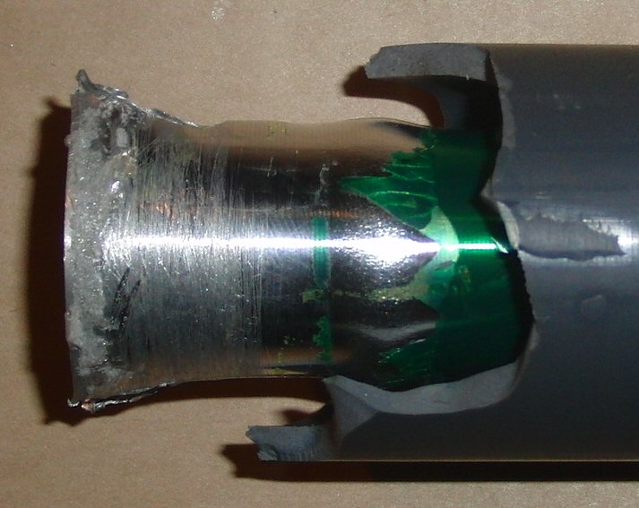

Here's an obviously failed attempt to stop a very fast and (pre-lathe) not too light "piston" with an air bumper, that's a lot of pressure to bulge the metal like that, and the space between alloy and PVC was filled with epoxy! The solution to that problem was the one I am suggesting here, a smaller diameter and lighter weight piston which made bumper material almost unnecessary.
