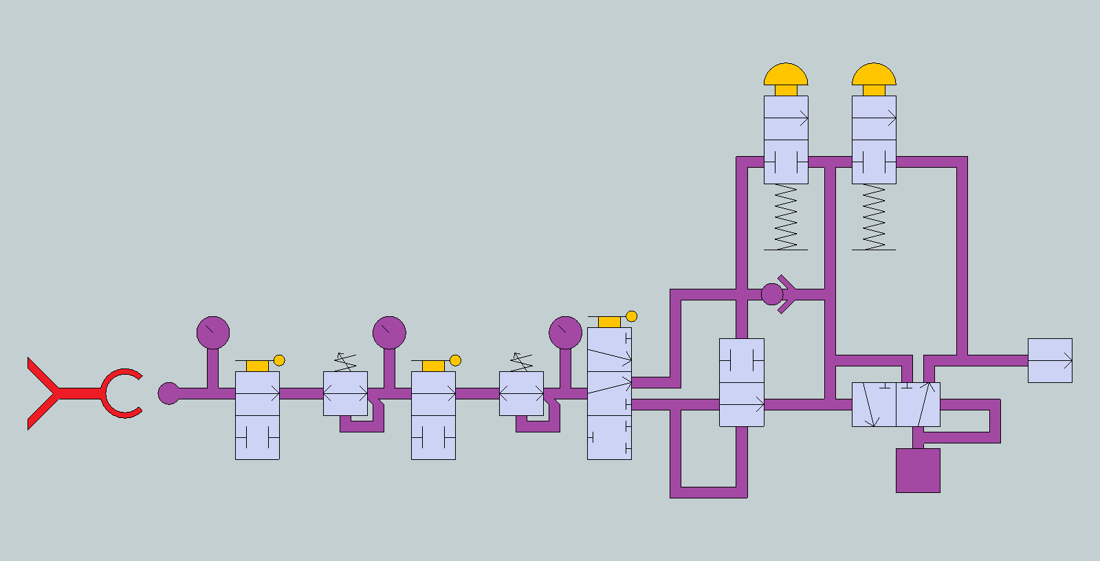

Here's the current scheme >=)
- oh god wtf is this!?!? oh, lol forgot it looked like hell >,<
- C41p50 v4 piping.png (15.82 KiB) Viewed 5633 times

Just a note, I didn't add them in, but there are hoses connecting the tank to the plumbing and the plumbing to the bolt....I was just too lazy to add them in on this version >,<

So I'm trying to build a semi-automatic charging system that uses the supply air(reservoir or continuous supply) to actuate its more complicated workings.
The idea goes something like this:
Connect air supply
adjust supply pressure
pressure actuates safety valve
adjust firing pressure
open "on" valve.
Pressure is stopped by safety valve
Projectile is loaded
safety valve is opened via pilot valve (safety pilot)
gun charges
safety valve re-engages at firing pressure
gun is fired via pilot valve (firing pilot)
Gun is prevented from re-charging via Pilot valve.
I have a system currently (see image).
But I was wondering if anyone knew of a better way?
thanks for reading!

- POLAND_SPUD
- Posts: 5402
hmmm let me think...But I was wondering if anyone knew of a better way?
...ohh I know piston valve/QEV + DCV combo
thatguydionysus
- Private 2
- Posts: 21
- Joined: Fri Aug 03, 2012 2:51 pm
you just described the current configuration...
piston Valve/toolies valve is in the bolt
qev is utilized with the tee leading to the pilot and bolt from the supply
and the directional control is the three way mounted outside
or am i misunderstanding...
if so, im sorry but could you maybe be a bit more descriptive?
