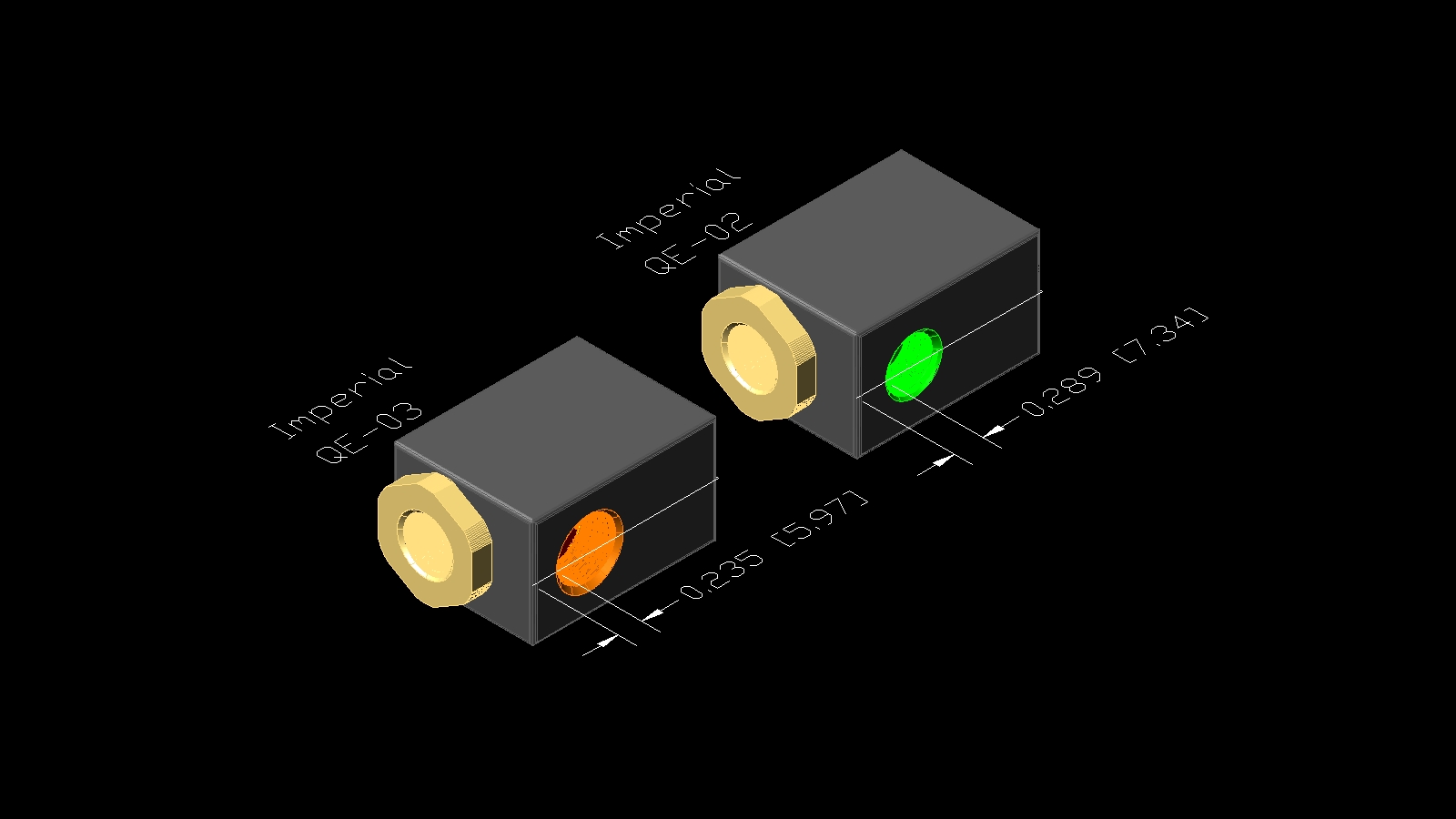

Thanks for the dimensions. dewey-1, can I please also get the distance indicated in the attached image?

The dimension that is really needed, is the hole center to the front edge.
The only difference in the valves is the port sizes as near as I can tell.
This side view shows why I disagree with 2.5mm.
