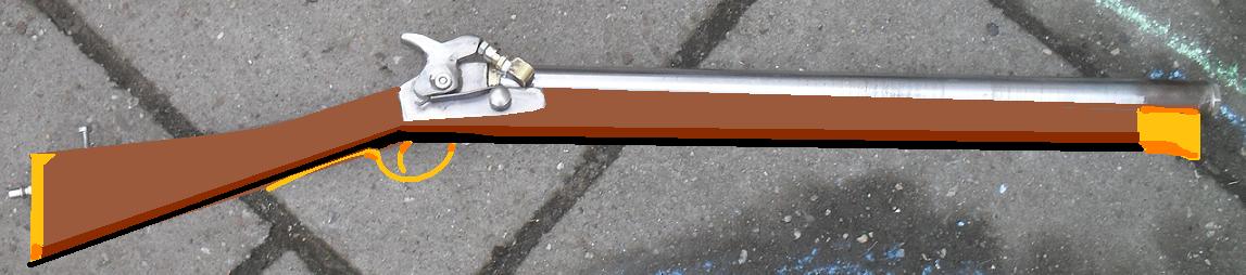

This is the idea..basically.<br />Will need to add a ramrod to the front grip though...

Looking great as always Brian :) I especially like the MS paint artist's impression hehe

Looking great as always Brian I especially like the MS paint artist's impression hehe
Thanks!
You always say that...
If the idea doesn't come across with a simple sketch...it is most likely not thought through very well.
