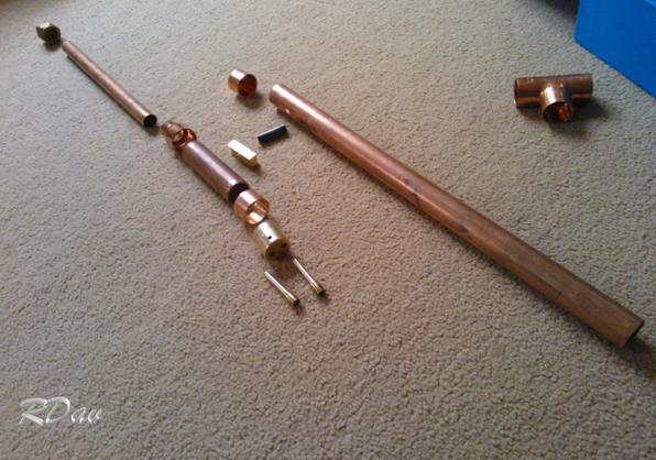

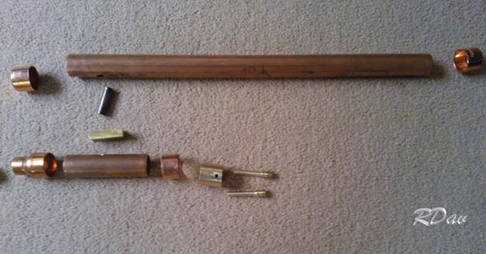

Well, initially intended for fully automatic cycling, this compact little 6mm multi-shot turned into an over-engineered hammer valve after my lack of a lathe made a low friction sealing face nigh on impossible.
Instead of scrapping the gun after initial tests were less than successful, I decided to transform it into a 6mm bolt action, fully capable of being magazine fed, but piss poor performance when it's correctly configured for mag feed (again, god damn those seals) So instead, at the moment it is muzzle fed.
The feed system was based on a fully automatic version of the Girandoni, that I designed and tested to great success at an earlier date in a testing rig, sadly the success was a one off, and this little beast will never hear the magical 'dakadakadaka' that it was intended for.
The two inline valves are both cut-down schraders, delivering enough gas for around 100 power shots (high-end airsoft power) all on a single fill, and the trigger is fully customized to have the 'perfect' weight when firing.
All the parts were made entirely by me, no lathe, no milling machine, just one determined guy and a file set, and all parts were soldered together, and hydro tested to 300 psi, no leaks.

The disassembled main mechanism.

Thanks, and yes you're right...mostly, the entire barrel assembly is fixed in a stationary position, with the rear of the barrel being blocked off, the bolt is forced to move forward like a blow forward bolt once it hits the valves until it clears the blocked portion, moving far enough to block off the magazine and simultaniuosly load the next pellet,
The two places I can't get the darn thing to seal is around the sides of the bolt, and the inside of the bolt where it slides along the barrel, without the use of a lathe it was nigh on impossible to get a good tight fit or put some o ring grooves into it to actually make it function as it should, so in the video, I removed the barrel assembly blocked off the central hole through the bolt (the 'breech') and let 'er rip
