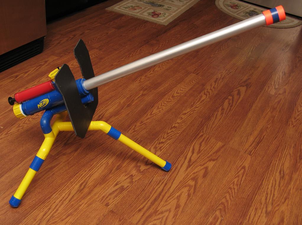

Thanks for all the feedback, they really are fun to make. Dont ask me what im going to do with all these, its like collecting guns or guitars you never seem to have to many and they all seem to be different even though they all do the same thing... make noise
Ive fired this one 3 times now, havnt stuffed anything in it yet, i got a parachute rig built but havnt tried it yet. Ive been trying to think of a place to go try it i need some space that isnt windy

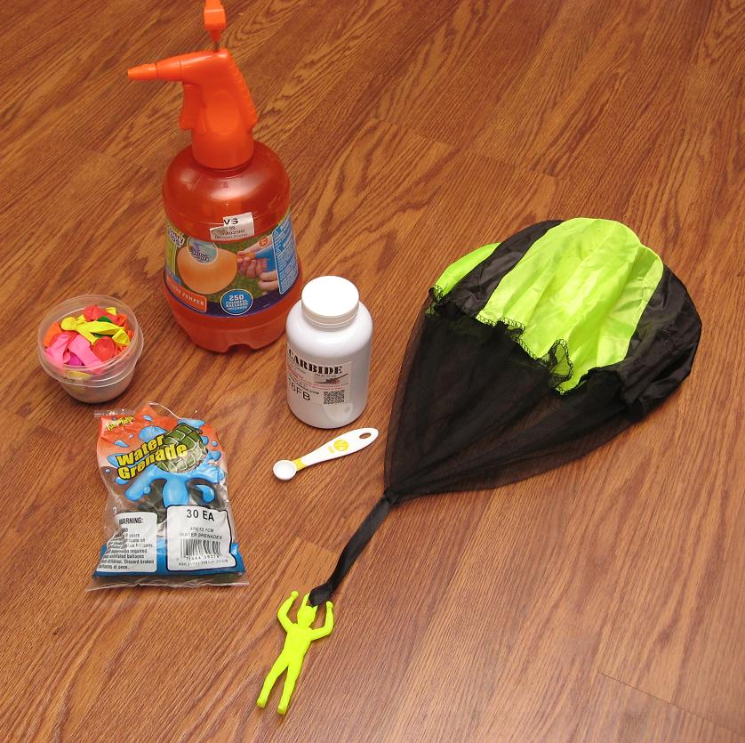

I thought of a little differnt setup, REALLY low power but enough to shoot empty 20oz pop bottles. Alot more quiet and i can do it in the back yard without causing to much of a problem. Unless they think its real now?
I found this little water balloon tank at CVS, it does 3 functions: fill balloons with air, water or shoot a mist. So it will hold some pressure. I cut the pickup tube inside that pulls up the water so insted it pulls in the acytlene wich mixes with the water. The volume of the tank is about what my 3" cannon uses so i use the same amount of carbide in the tank. Each balloon uses 5 pumps to fill the balloons making the perfect little charge to shoot the empty pop bottles and the little parachute figure. The air to gas is very consistant and WAY more effecient then the cannons wich use 1/4th tsp per shot. This setup will shoot the rockets about 10 times per 1/4 tsp of carbide.
Ill get some video next day it clears up enough to get out and shoot em again.

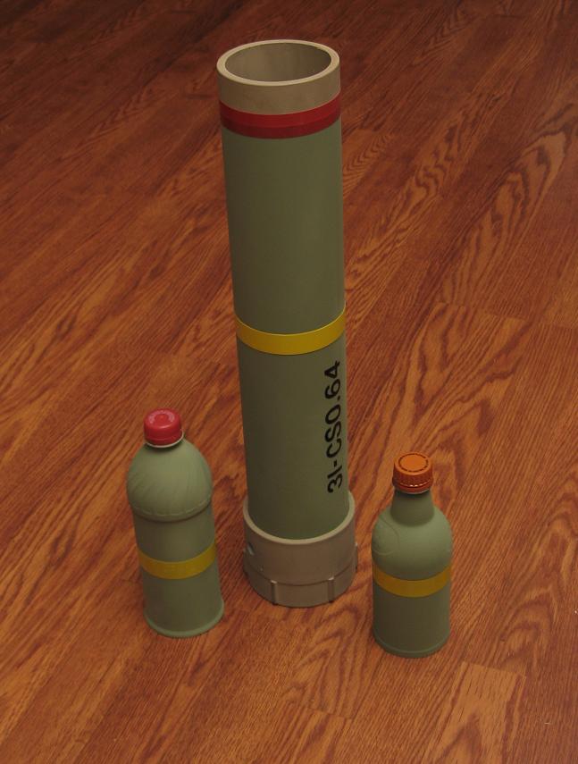

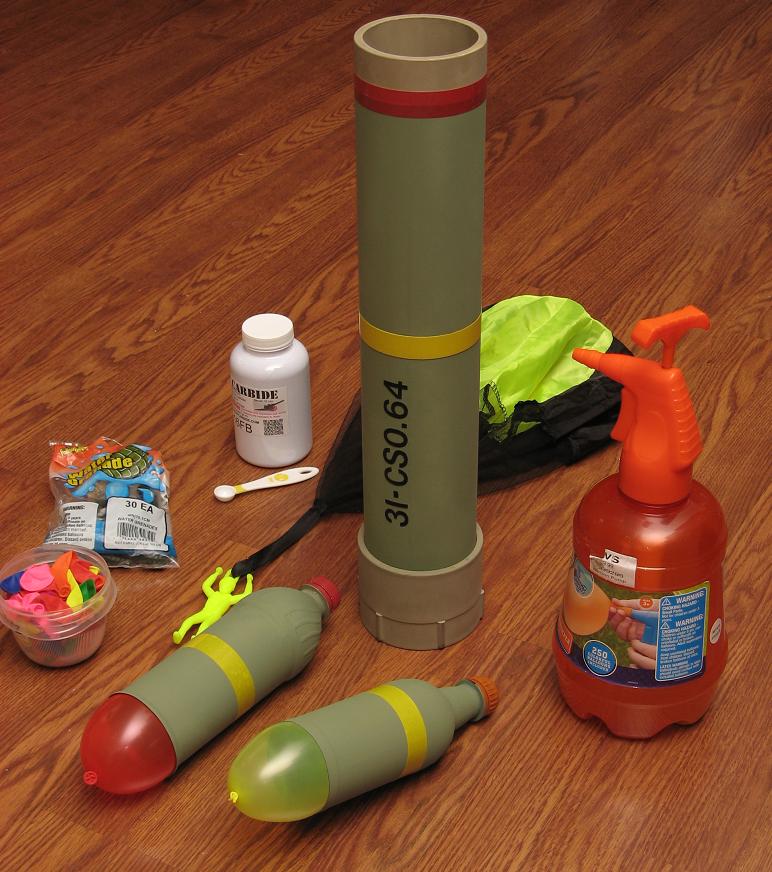

There is a couple guys who started this youtube DIY channel called "SonicDad" they build all kinds of home brew stuff using household items or things you can buy localy and then modify and tear up.
They designed a carbide cannon project #59 Sonic Boom Carbide Cannon. Its a Super Sonic expert level project.
They give all the plans, sizes of pipe, the length you need to cut everything.
I built one last weekend with my friends son, he is 16 and likes blowing stuff up like i do lol.
Here is how mine turned out.
