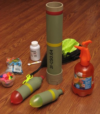

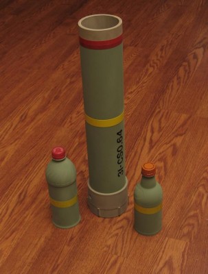

Thanks for all the feedback, they really are fun to make. Dont ask me what im going to do with all these, its like collecting guns or guitars you never seem to have to many and they all seem to be different even though they all do the same thing... make noise
Ive fired this one 3 times now, havnt stuffed anything in it yet, i got a parachute rig built but havnt tried it yet. Ive been trying to think of a place to go try it i need some space that isnt windy
Thats funny because when i put the first piece of metal contact paper around the chamber i thought the same thing its starting to look like a "Thunder thermos" lol i bought some extra parts to make the handle connect at the top and bottom and my plan was to put 2 straps and connect it at the top and bottom like a real handle but it was to long with the igniter in it. It still came out ok i think.Boomer58cal wrote:Fantastic! Looks great. I just got an idea though... you should disguise one as a stainless steel thermos. You could make a piece that threads into the barrel that's actually holds coffee and has one of those screw on cups/lids. That way when your neighbors called the cops you can actually pour the officer a cup of coffee out of your cannon.

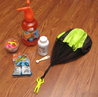

I thought of a little differnt setup, REALLY low power but enough to shoot empty 20oz pop bottles. Alot more quiet and i can do it in the back yard without causing to much of a problem. Unless they think its real now?
I found this little water balloon tank at CVS, it does 3 functions: fill balloons with air, water or shoot a mist. So it will hold some pressure. I cut the pickup tube inside that pulls up the water so insted it pulls in the acytlene wich mixes with the water. The volume of the tank is about what my 3" cannon uses so i use the same amount of carbide in the tank. Each balloon uses 5 pumps to fill the balloons making the perfect little charge to shoot the empty pop bottles and the little parachute figure. The air to gas is very consistant and WAY more effecient then the cannons wich use 1/4th tsp per shot. This setup will shoot the rockets about 10 times per 1/4 tsp of carbide.
Ill get some video next day it clears up enough to get out and shoot em again.

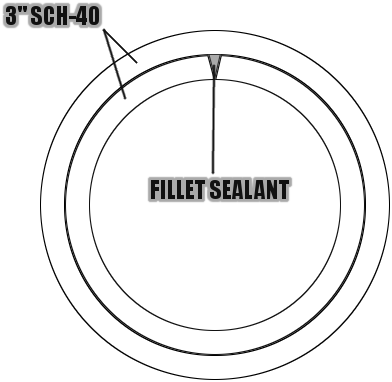

For tennis balls people have sleeved 3" pipe inside of itself after cutting a strip lengthwise out of it... given your short barrel sizes, it shouldn't be too much of a chore (compared to building "full-size" (4' and up) barrels).
EDIT: my bad, didn't see the middle pages.
Guess it's info you could use anyways...
- sleeve.png (33.7 KiB) Viewed 7491 times
How do they fit after you sleeve the 3" and use the regular cheap tennis balls? using the 3" and the kids low bounce balls they fit nice and loose but they are about $1. a ball and after a few really pounding shots it starts to burn the fiber up on the tennis balls
