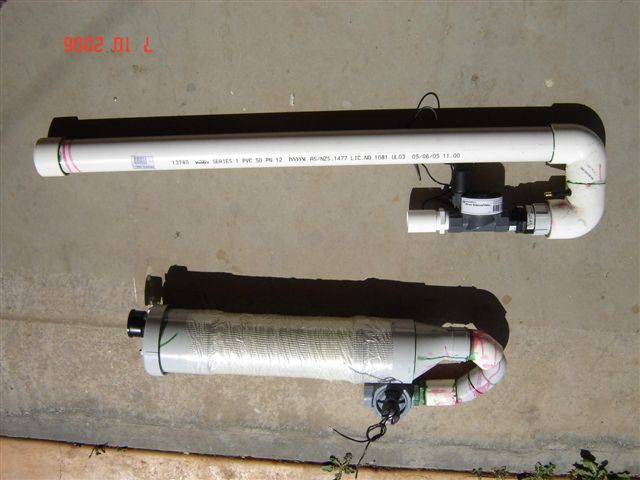

hi all (forgive me as this is my first post) and i may have to do a lot of searching but.....
most people talk about sched 40 pvc pipe in USA/UK
in aust i have found pvc pipe with stamping of (pressure pipe) PN12 pvc pipe and was wondering what the psi rating wold be?
i think it at 1200 KPA
specs:
nom size 50.0
od dmin: 60.2
od Dmax:60.5
mean bore: 53.7
wall ave: 3.4
could someone give me an idea if this OK at 100 psi
my res chamber is 50mm pipe by 97cm long
Cheers,
Richard

ok so 12bar =174 psi so, i would be sweet at 100 psi with PN12
(i did use primer and green glue)
OK so what is the "burst" pressure on PN12 or will it go bang at 12bar?
...richard
photos show first gun (big chamber) i have had it 40 psi but not sure on the rating of the 4 inch pipe so i woul duse it (cotst me $80)
oh well that the learning curve , shame as it has a gauge in it....
othe runit is PN 12 so once the glue drys (24 hours) will pump to 100 psi and try it
...richard

The pipe is rated to burst at 3x its running pressure so 3x12bar=36bar/529psiburst pressure.I get my suplies usualy fomr reece they know be by name and give em the small of cuts which are of no sue to them and they like seeing my guns i make aswell.Bunnings is ohhk but they dont stock large diametre pressure piping.The fittings are priced ok but.

rna_duelers, that's an interesting snip of info there. I wasn't aware that the "burst rating" was 3X the pressure rating. Now I feel less terrified pumping my gun rated to ~260Psi to 60Psi.

Is that for all pipe?rna_duelers wrote:The pipe is rated to burst at 3x its running pressure so 3x12bar=36bar/529psiburst pressure.I get my suplies usualy fomr reece they know be by name and give em the small of cuts which are of no sue to them and they like seeing my guns i make aswell.Bunnings is ohhk but they dont stock large diametre pressure piping.The fittings are priced ok but.
If so then 3/4 pvc may withstand a 1000 psi before bursting?

It is indeed,they use a saftey margin for all PVC at 3x burst(Australian PVC)My uncle told me he is a plumber and metal fabricator and he said i would never get some PN18 pipe to burst with my compressor as i would need a pressure supply of 800psi for it to burst.But dont hold me responsible if you pump a piece of pipe to 500 psi and it bursts they are only safety margins so stick to the rated pressure.
