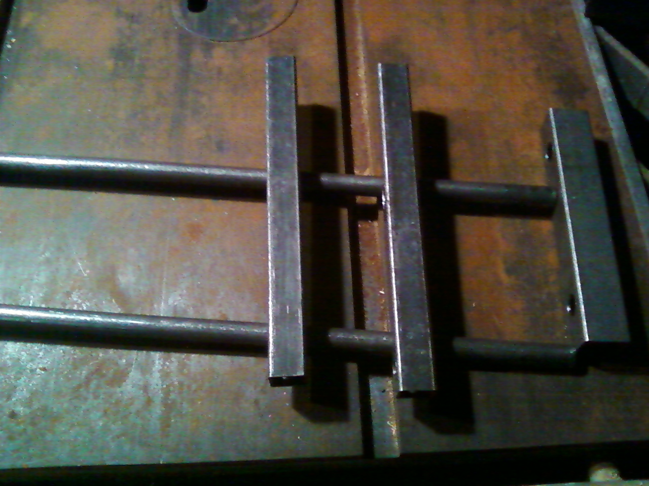

After perusing the metal section, I decided I'd try a slightly different tack. The 1/2 inch steel rod they carry is quite stiff (according to the ISO "stand on it and see if it bends" test :lol: ). It has a certain amount of flex to it over a 4 ft length with 140 pounds on it, but I think over 18 inches it should be stiff enough to do the job. I grabbed a length of it and a length of .95" steel square tube.
The plan is to use three 6-inch lengths of steel tube to support two 1/2 inch steel rods as the lathe 'table'. At five inches apart, with the maximum distance between supports being 18 inches, it should be stiff enough to work aluminum and brass at the least. I'm hoping it'll be able to handle iron and softer steels , but I won't be too disappointed if it can't.

I decided to cut the steel square tube with a hacksaw instead of my angle grinder. A little more finesse is never a bad thing.
Pardon the poor picture (cell-phone camera). Anyhow, never ignore the usefulness of a good centre punch; drill bits have a tendency to wander, even if you have a drill press.
One of the steel rods, with just enough chamfer to allow it to start in the holes in the steel tube, but still achieve a tight fit.
This was about as far as I've gotten as of this evening.
I'm leaving the parts as they came from the store until the lathe is almost completely finished. I figure if I give the whole thing a good tight fit, any moving parts (the tailstock sled and the tool carriage) will be nice and snug - but still movable - after I polish everything down.
