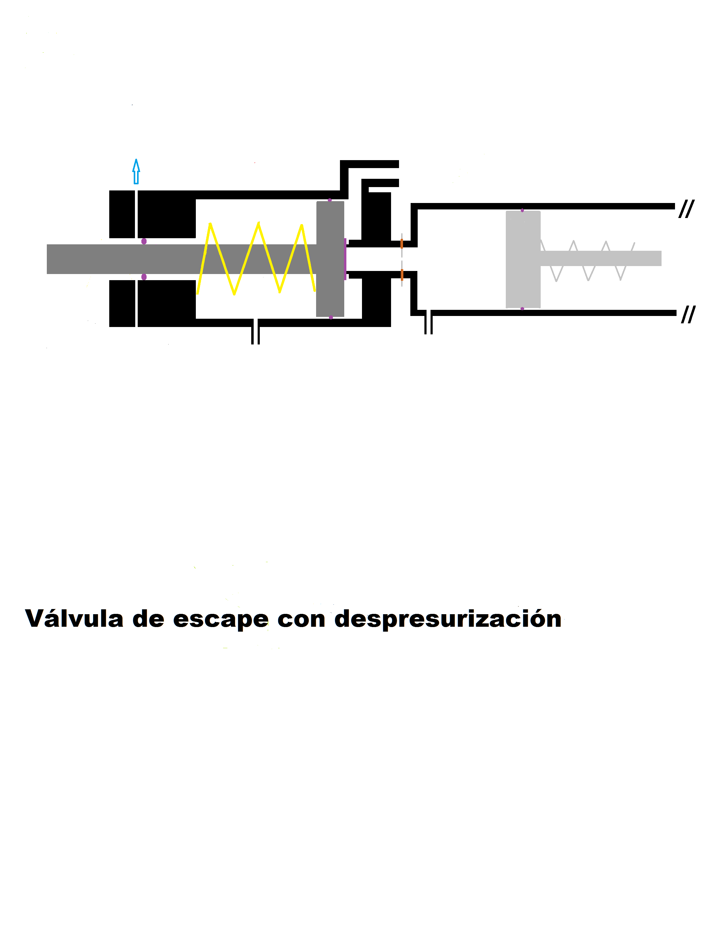

I have tried this solution to not use rupture discs. It works perfectly. This afternoon, I will try to make a small video of its operation. I wanted to share the improvement for this project.
I built a test valve and combustion chamber for low pressure, about 2X - 3X, as shown in the diagram. It is a classic piston for hybrids but with depressurization. In this way the valve remains open.
I needed to know if it works, and it was not the purpose to make any hybrid weapon with this. Just try in reality if it works. With this solution, the piston of the combustion chamber completely cleans the burnt residual gases, because the valve remains open after the explosion, with a soft spring.
The valve closes, activated by the movement of the gas charging system. When pressing the command of the valve that loads the dosed gas, it pushes the stem and closes 8)
Interesting... I don't understand why it needs pressure to keep the piston shut though, isn't the spring sufficient?

UHHHH !! I'm sorry ... I forgot to erase the spring in the diagram. Here I leave it as it should be, like this one. Precisely, the design pretends to avoid is the spring because it leaves the valve closed and the burst piston of burned gases in the combustion chamber can not clean.jackssmirkingrevenge wrote:Interesting... I don't understand why it needs pressure to keep the piston shut though, isn't the spring sufficient?
It seems that heat has affected my head.
Ah, makes sense now!

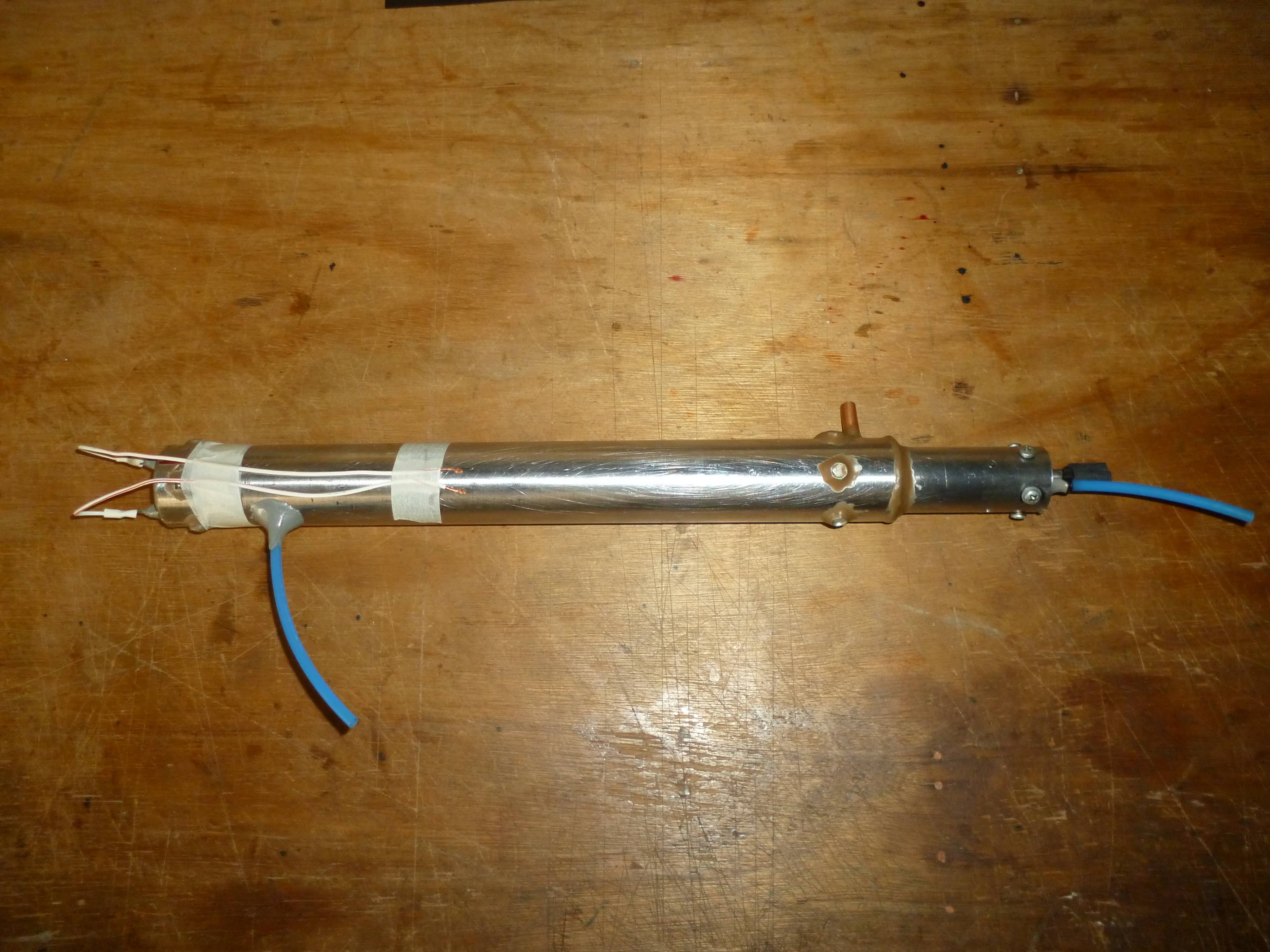

Test the small valve at 2X. The idea is to see if it works or not, and yes, it does it correctly. When I get down to work to make the new prototype, I'll build one for this weapon. This is just a quick experiment :bom:
