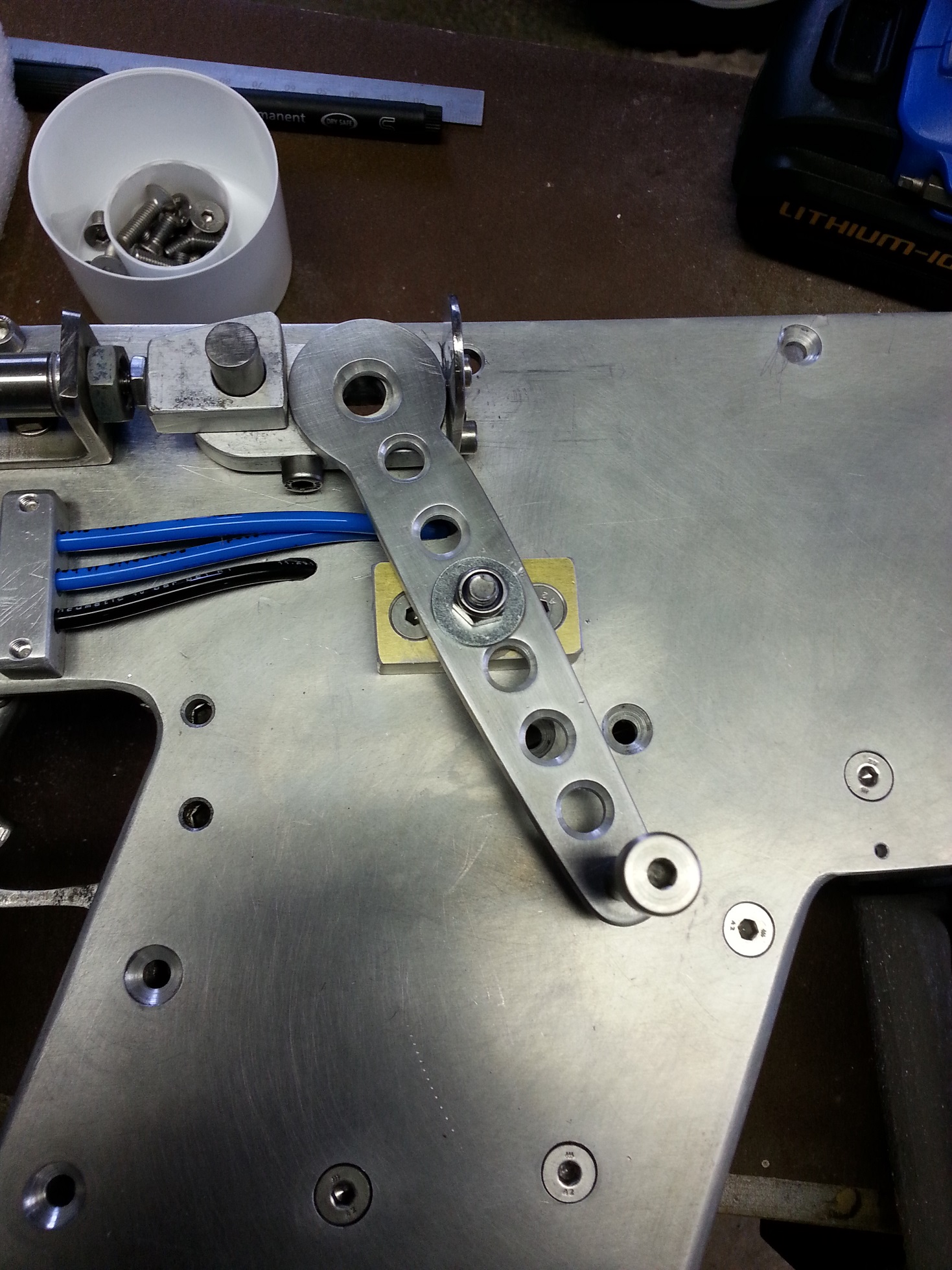

+15c outside today instead of - so I got in the workshop for some BFG modification work.
Well it seems to work nicely. :D
Other ideas I have planned are a shut off for the reload cylinder so it needs to be loaded manually not semi-auto :idea:
Why? because I can and I might not want to leave a BB loaded. :shock:
Removable magazine, mainly to make it easier to store and to check if it is loaded or not, no way at the moment as everything is covered.
Box in the magazine and change the hoses to all black, just for looks 8)
