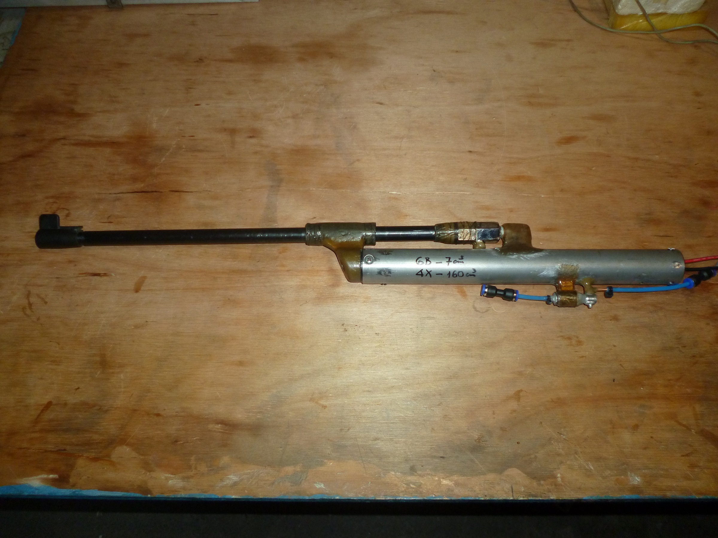

4X shot test that is as far as the spring I have.
The "weapon" is only to be able to shoot safely, outside of my workshop, because it is very noisy. I will try to make a basic silencer.
I am almost determined to use this valve integrated to the burned gas scavenging system, for the semiautomatic.
It has the same power as the first autonomous hybrid, with the difference that this hybrid cartridge with bursting disc burns 13 cm3 of gas and this, the video of the test, 7cm3.
Dejo un par de fotos. :D

Yes, I have fallen in love with this improvised rejunte of workshop elements, post apocalyptic! 8) Now it looks black and has a grip on the front. I am making a short weapon with the same system, with recycled elements, something similar to this but smaller, for fun.
Regarding what you ask me, I told you that this was a valve test integrated into the burned gas cleaning system. This will be the one I will use to make a semi-automatic hybrid, and in small hybrids of air loading by pumping, with the same system that I have tested, the one in the previous videos, the post of semiautomatic, and with the other systems that are already tested. This was the idea, but I had to prove if this part worked correctly. It is for this reason that I did not attach the other systems. I think it's the last piece of the puzzle that I needed to prove ...
When I have something else, I'll put it right here. Greetings Jack! :)

Yes, it's quite noisy, I'm just trying to find information to make a simple silencer. I'm bothered by loud noises ...
Here I have a picture of the "invention" painted to make the appearance more aesthetic. Thanks Air2theBrain :)
