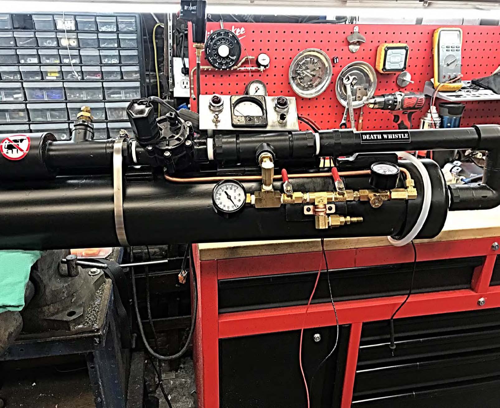

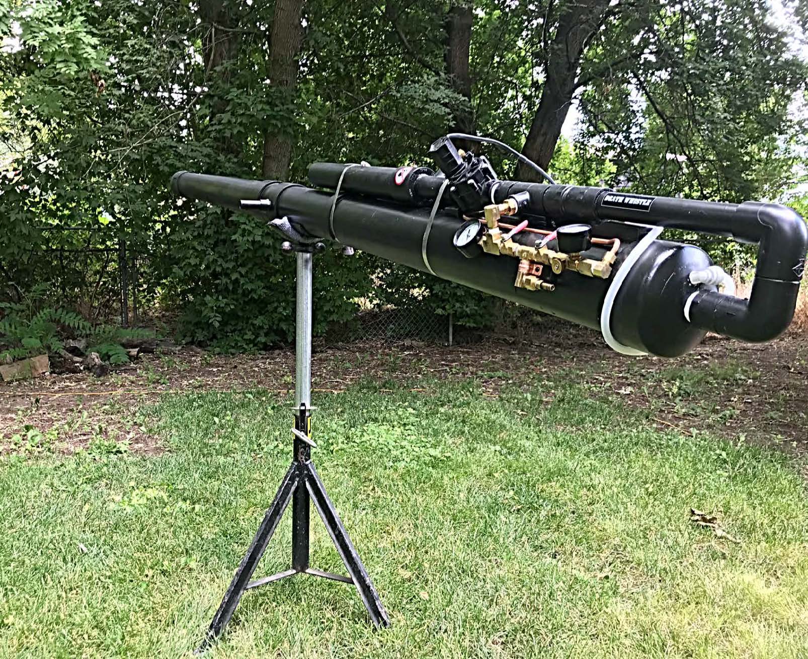

I rebuilt a gun design my Dad did years ago. I took it out in the boonies (deserts of Utah) and was getting 600-650 yards at 60 psi. I was pretty impressed, but I have no data for comparison. 650 yards is crap for all I know. :) I was wondering what others were getting. Couple of pics below.

3fenders wrote:650 yards is crap for all I know. :)
At just 60 psi, that's pretty good!
That "no bullshit" sticker is vaguely familiar... was you Dad active on these hallowed pages or spudtech before it?
Also, what the... is there a part missing in the second image? It is over/under with a sprinkler valve and ridiculously huge chamber or a coaxial with a ridiculously large pilot?

10' long, 4" PVC. Barrel is 1 1/2" schedule 40 pvc. My Dad is a retired engineer & machinist with a garage full of machine tools and too much time on his hands. He fabricated a tool that bores the barrel ID to 1.7". A real home made beauty. I'll post a pic of it when have time. Some balls won't fit, tolerances are pretty small. It originnaly had a 3/4" sprinkler valve, I up sized to 1".
We both have a proclivity to over complicate things in every way possible.
Missing parts in second pic include a control panel with enable switch, fire push button, vintage DC voltmeter and lights. 3, 9 volt batteries to power it & really BANG that sprink solenoid open. I'm an electrician by trade so any project must have lights, right? Firing recoil would bust out the lights & wrecked the voltmeter. control panel has been scrapped.
Unseen in the pics is a secondary pressure chamber on the right side. I was having trouble getting the piston to seat, so... in true over engineering problem solving, It was an attempt to blast air behind the piston to seat. It didn't work, I had piston washer issues. Most people wonder what it's for, people who are addicted to this stuff tell me right out "Well! That's useless" Part of the fun.
No bullshit sticker is mine, but the name 'DeathWhistle' came from a suggestion to another user on this board. Name is amazingly appropriate. I put 2" pipe on the valve exhaust hoping for cool noise. the chamber has way more voulumn than necessary to launch the ball, so remaining air escaping makes a wheezing, dying train whistle sound.
