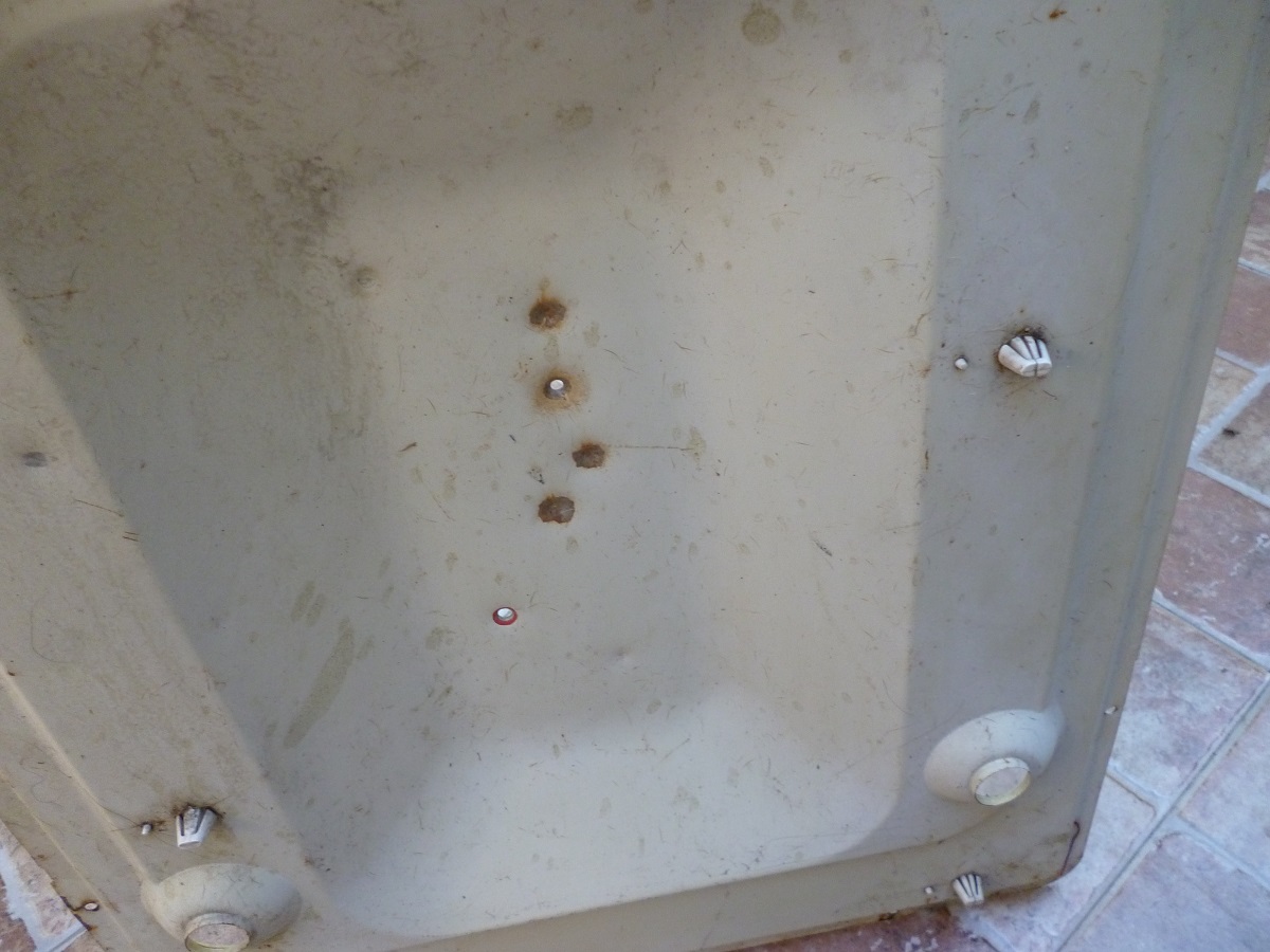

Update of today's prototype.
I have included a hold with an o`ring. The strength has increased considerably. He passed a 0.8 mm steel plate cleanly with 7X, and the noise has been kept controlled with the muffler I have installed. I have fired without the moderator, but it is very unbearable for my ears. It was just to know.
In the photos, the red mark is mine, 6.35 mm, the other one is a 5.5 mm pcp.
