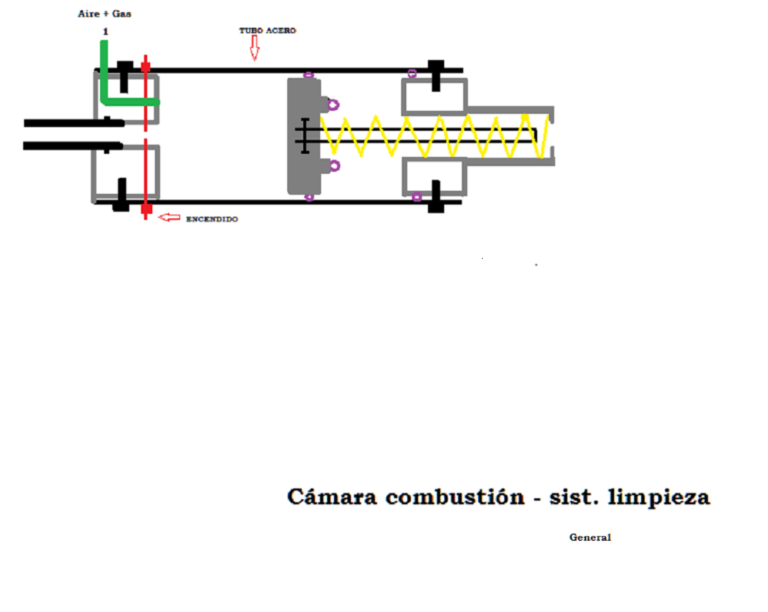

No. The cartridge incorporates the rupture disc, an o'ring for the seal and the ammunition. These are the diagrams:
In my case the heat is a lot. With an ambient temperature of 30 - 35 ºC and firing every 20 or 30 seconds, everything heats up very quickly because heat accumulates. Enter more calories than it dissipates because there is not much time. I shoot rounds of 4 or 5 cartridge and let it cool. The resin gets very bad with the heat.
You can continue with your project here, or open a new thread, as you prefer. I will be attentive to talk about this and help as much as I can.
