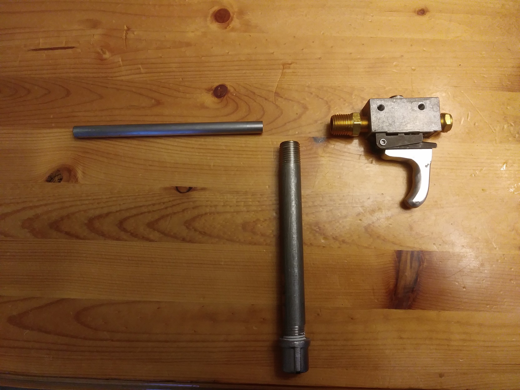

Making a super simple 0.177 BB pistol, going to be muzzle loading, have some parts already, waiting for 1/4" Ebay QEV and compression fitting to attach barrel. :D

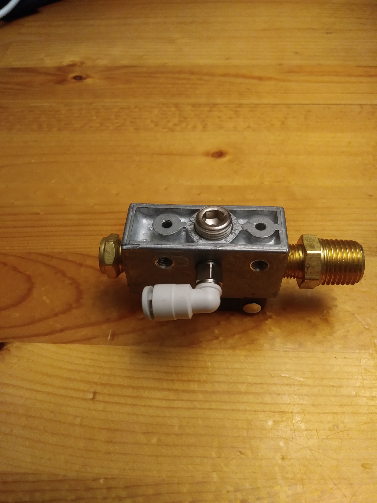

Made a new M5 port on the side of the trigger valve so I can keep the top profile low. :idea:

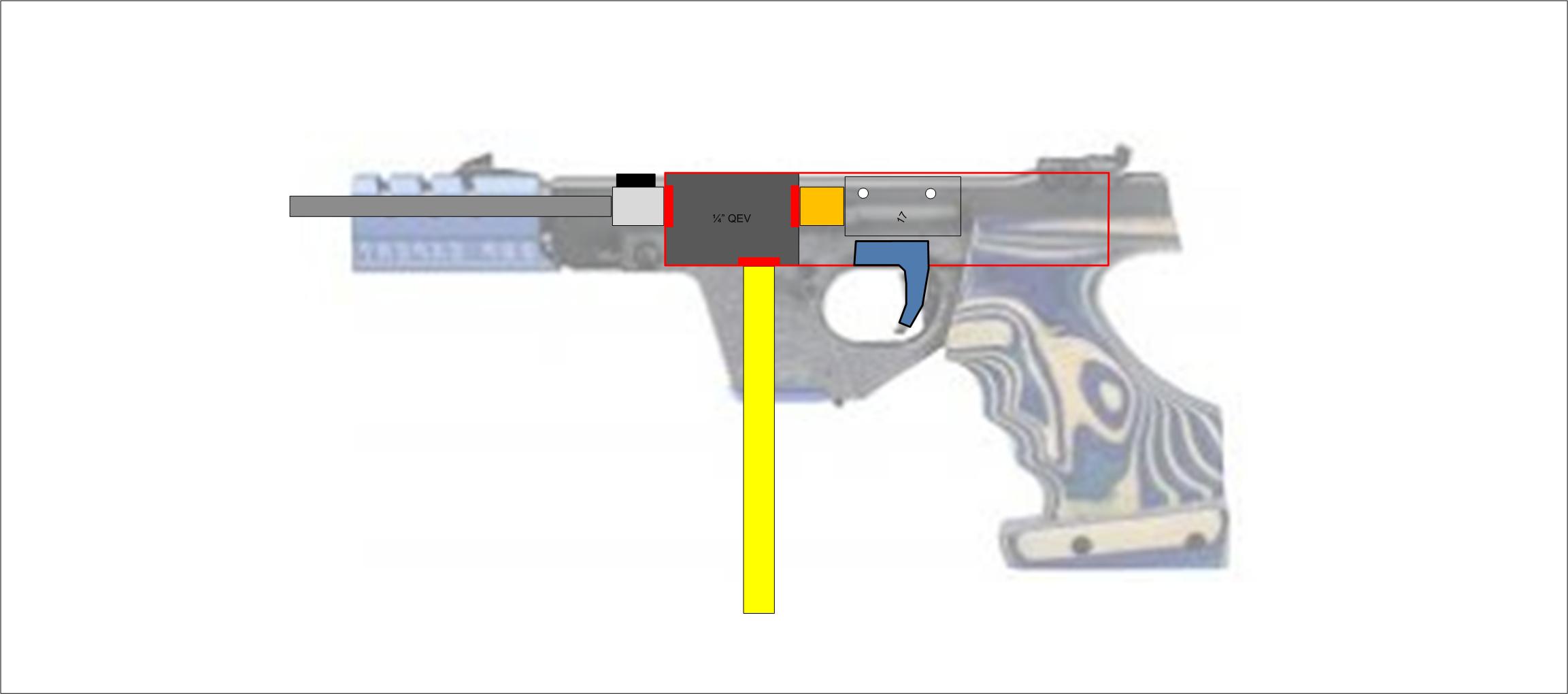

A possible pistol style, reduced chamber volume but lighter and more usable (fun), was going to say practical but :wink:
Main Pistol.jpg (27.38 KiB) Viewed 7133 times

Sun Mar 03, 2019 11:14 pm
[quote="farcticox1"]A possible pistol style, reduced chamber volume but lighter and more usable (fun), was going to say practical but :wink:
are you piloting that with a simple push button valve? I want to build one of these for golf balls now :lol:
