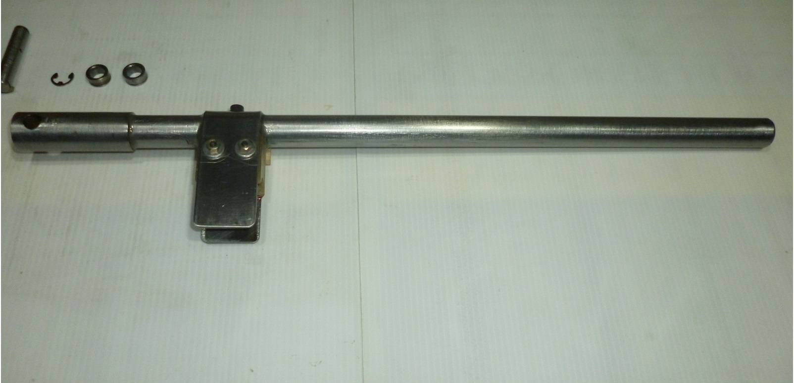

Sun Apr 28, 2019 10:02 am
This project continues to advance. I have completed the lever of the air pump, and I have tried this part. It is soft to pump the air and with 5 pumps achieves about 7 bar, for 10 ml of butane gas. I need to install the firing barrel and the handle, stock and piezo igniter, I forgot to buy ... :?
I'm going to use the piston that I already have, fiberglass, and the brake caliper I'll use it later, because I have not got it yet.
I have also finished the gas charging system and opening the exhaust valve. I'm going to use this system that is simpler, so as not to include the solenoid valve, batteries etc. You can change to this system in the future, because I have left what is necessary to do it without modifying anything important.
