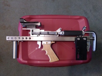

Self contained airsoft, pump action.

Looks pretty good. I like the "bow drawing" nature of charging the thing.

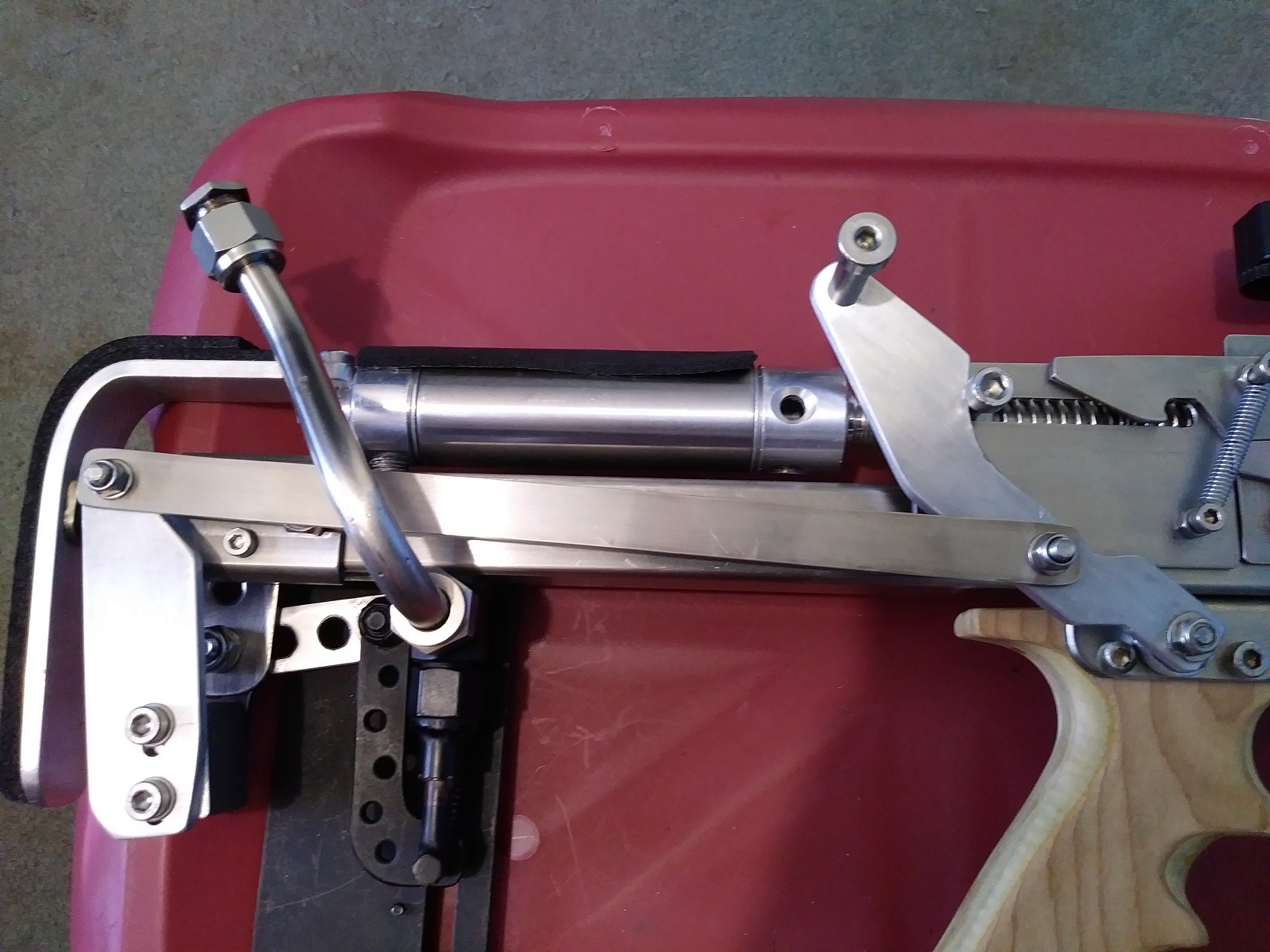

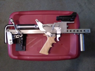

Got everything working, charging and loading is now from the side handle, the front grip is fixed, this allowed me to cut off a bit of weight as well. :o

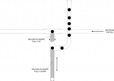

Neat, is that tubing the magazine? If so how are you handling loading one round at a time?
farcticox1
Posts: 1081
Has thanked: 69 times
Been thanked: 96 times
Mon Apr 13, 2020 4:26 am
Yes the tube at the rear is the magazine, it holds 22 BBs and gravity feeds one at a time when the plunger goes down, the last few don't feed well as they are horizontal and are not pushed from above, so I normally shoot like 10 then reload it.
