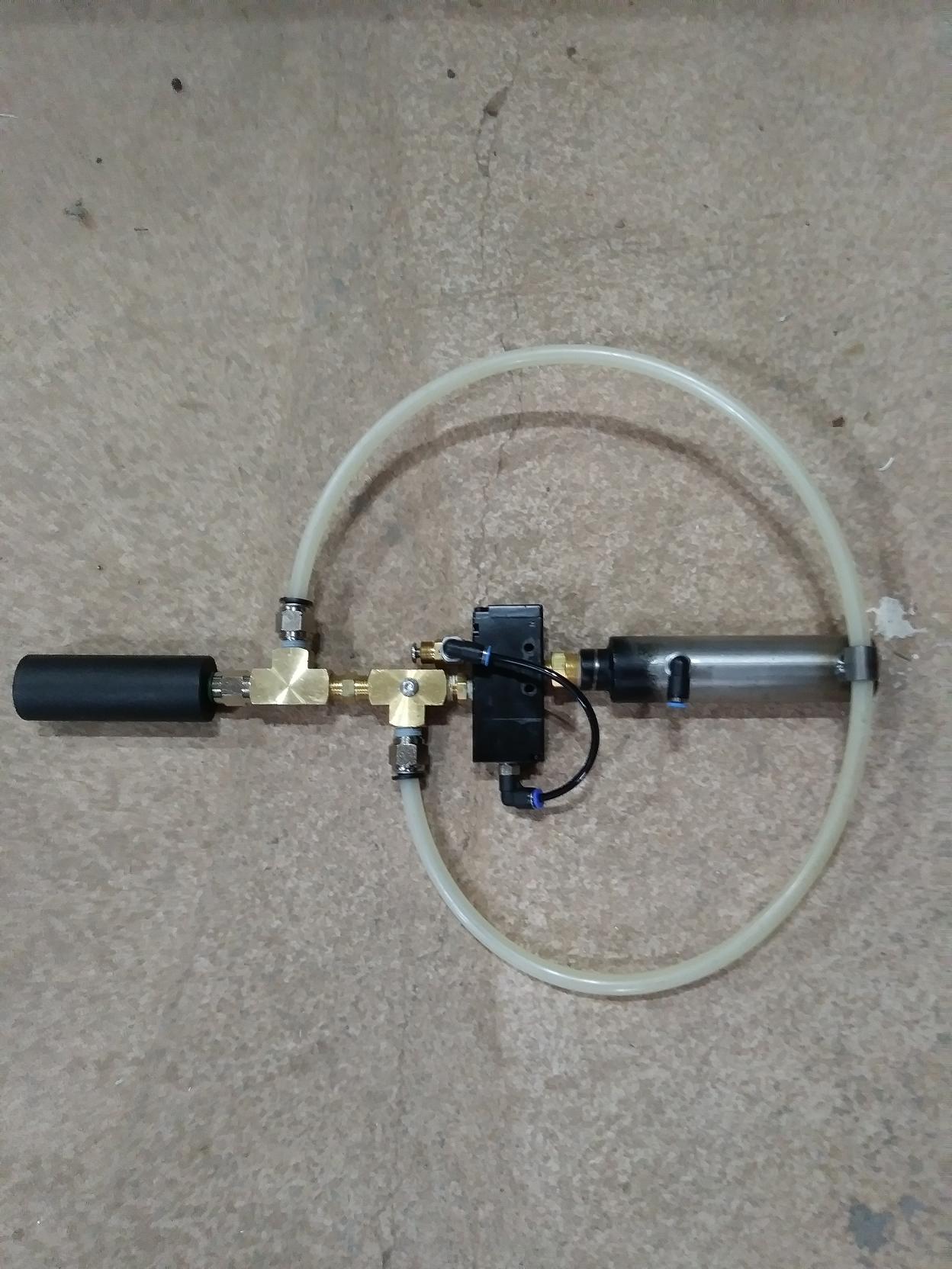

I sort of made a full auto pistol from pieces I screwed together, the chamber is the only piece fabricated. Holds 130 bbs, rate of fire is insane, can get 4 bursts if I'm quick on the trigger. Compressor connects to the small fitting on the chamber at 150psi. The valve is a 5/2 1/8"' port pilot operated, the trigger is screwed into the valve and takes air from the normally open port. Want to try a T fitting on the magazine tube to make filling easier.
						Full auto airsoft pistol

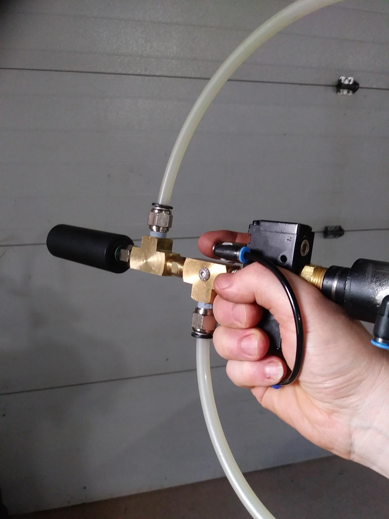

Finished with a T for loading, extended grip and a bit of paint.
