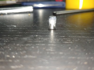

 Okay I have all my new components! Unfortunately though, since my piston's seal has already worn out, I cannot shoot the new ammo quite yet.
  Okay I have all my new components! Unfortunately though, since my piston's seal has already worn out, I cannot shoot the new ammo quite yet. For the new seal, I am using 1/16" Ultra Strength Neoprene from McMaster, which I think will last much longer than the old seal, which was simple Natural Rubber Latex of the same thickness from the hardware store. The epoxy is still setting, but I hope it works well and for much longer! Because I would also like to make a more aesthetically pleasing gun that is not serviceable, and don't want the piston wearing out because then it'd be useless.
