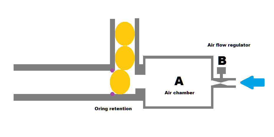

One possibility to organize the bbs and save air, is as follows.
The holding oring only releases the bb when it reaches set pressure, and immediately another bb seals the outlet. Sealing time is what it takes a 6mm bb to travel 6mm, aided by the suction of the barrel.
The firing frequency is regulated by varying the time it takes for chamber "A" to reach the firing pressure. This is regulated by varying the amount of air that enters the chamber in a given time, with the flow regulator or an adjustable restriction of any kind.
The more air enters for a given time, the faster the chamber fills and the pressure to overcome the retention o'ring is achieved in less time and vice versa.
The problem with these designs in practice is that the second projectile frequently blocks the barrel before the first projectile has exited the muzzle.
I floated some ideas to compensate for this here.
You are absolutely right, I did not realize this problem. The bbs are going to run out of air before they need to ... :?
