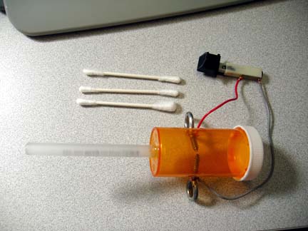

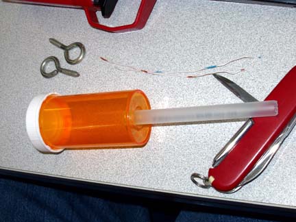

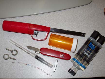

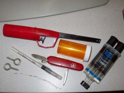

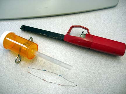

A friend of mine recently turned me on to the whole spud gun thing. After seeing everyone else's creations I have been itching to build my own. I don't have a ton of hardware lying around, and I wanted to get something going now, so I decided a mini pill bottle cannon would be a good shooter to start with. I put this thing together in less than an hour (had to wait for the epoxy to dry). I based it on PCGUY's pill shooter with my own modifications. I used a clear 2" pill bottle, a clear pen cylinder, two of those little hook screws used for hanging things, and a clicker and wires out of one of those long click lighters. It's very basic, but quick and very easy to make.
However I am having trouble getting the fuel to ignite. With the clear tube I can monitor the mechanics inside the chamber, and I can see that I am getting a good spark, but still no bang. As fuel I have used WD-40 and I have used Starting Fluid (aka. Diethyl Ether), but still no luck. Any advice? :?
Here's the pics...

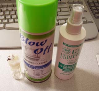

Ok, I'll try the butane. Man, I've tried isopropanyl, cologne, and a few other things but still no bang. I'm only giving it one spritz into the chamber. Should I let it evaporate a little before closing the chamber or should I close it immediately after adding the fuel?

:? I don't get where I've gone wrong. I'd hate to just toss it, but I've tried everything I can get my hands on, and it still won't fire. Butane, BlowOff (butane & propane), ice remover (isopropanyl), etc...
I still haven't tried the banacca, but with the poor luck I'm having with all the other stuff it may just be a waste of time. or is it???
