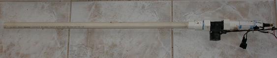

It may look small but this cannon packs a punch. I designed it to ba be a nice, quiet plinker. The chamber is extremely small and that means that it only takes two pumps from my big bike pump and around six from my small pump to get it to a decent pressure, even though I mostly use my propane pneumatic fill setup now.
Here are some specs:
-20mm x 10cm chamber (tiny I know)
-6mm x 65cm barrel
-20mm sprinkler valve
-Handmade wooden stock
-Nikko 3-9 x 40 scope

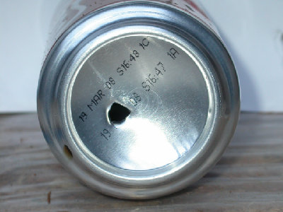

Coke can from around 5m, the front was severly dented

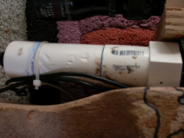

Chamber
Chamber

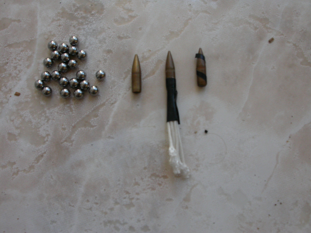

Ammo (left to right):Steel BB's, .224 FMJ, .224 FMJ with stabilising tail, .224 FMJ with tape 'rifling' to induce spin

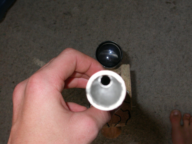

The business end
The business end
