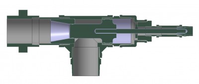

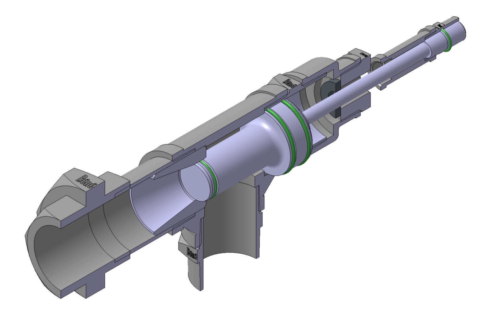

Hi all,
Attached are some images of the designs of my first hybrid cannon.
I've been working on piston valve and wanted people thoughts on the design that I'm at currently.
I plan to use o-rings to seal the chamber from the barrel - anyone had any luck with a design like this?
All comments welcome
NOTE: the images do not show the barrel!
Regards
Stuart
Regards
Stuart
- wyz2285
- First Sergeant 2
- Posts: 2388
- Location: Porto, Portugal
- Has thanked: 1 time
- Been thanked: 4 times
The piston won't open.
The area of the barrel side need to be smaller than the area of the pilot side.
It is tho.wyz2285 wrote:The area of the barrel side need to be smaller than the area of the pilot side.

Ohhh the o-ring is in the T not the piston. Well yeah that will work, need low pilot pressure tho, loos like a small difference to me.

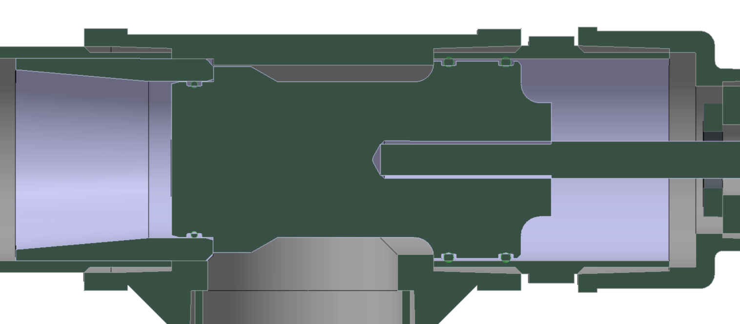

Thank you for replying.wyz2285 wrote:The piston won't open.
It was obvious really!
I'm made some changes to the design, incorporating a weld-in bush to reduce the diameter of the piston at the barrel side.
Again, any thoughts and comments are appreciated
Regards
Stuart

Stuart,
I like the design. I'd like to see the barrel side diameter be closer to the pilot side diameter, similar to how you had it in your first drawing, but not quite that close. The closer they are, the less pressure you will need in the pilot area. With less pilot pressure, this means less stress and abuse on the piston during the fueling cycle and operation will be easier also. You have to use the surface areas of the piston to calculate how much pilot pressure you'll need for a given opening pressure.
I see a small edge of engagement where the piston seats against the T-housing. I'd like to see a larger step there. If the pilot pressure has to be high, and you have a tiny step of engagement, I'd expect that edge to experience some high stress and abuse maybe. Just a thought.
Also, if you make the front of the piston very close in diameter compared to the back, again, you can have a low pilot pressure. If you increase the volume of the pilot area so the air doesn't compress too much, and if the pressure is low in the pilot, then you don't even have to worry about venting the pilot for each shot, but you will need to have a bumper on the front of the piston as well as the back. I know this works because I just made a piston hybrid based on this principle, but it would change your design by quite a bit so I'm not sure you want to go that way. Just thought I'd mention it.
What mix are you looking at? Based on the piping component design, I'd assume the standard 10X?
Keep us updated.
Keep us updated.

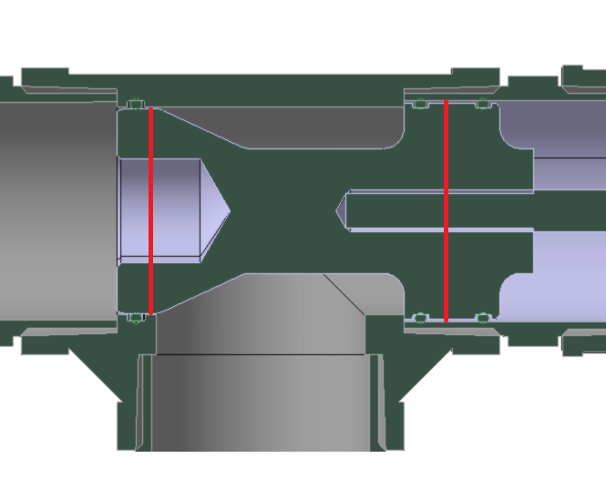

Thank youMoonbogg wrote:I like the design.
Moonbogg wrote:I'd like to see the barrel side diameter be closer to the pilot side diameter, similar to how you had it in your first drawing, but not quite that close.
To address both of these comments, I've updated the design again as shown below:Moonbogg wrote:I see a small edge of engagement where the piston seats against the T-housing. I'd like to see a larger step there.
There is now a larger face of engagement where the piston seals the barrel and the delta between the piston end diameters has reduced.
What are you thoughts on this?
The diameter of the piston on the left (barrel side) is 41mm and the right (pilot) diameter is 52mm - is this close enough?Moonbogg wrote:if you make the front of the piston very close in diameter compared to the back, again, you can have a low pilot pressure.
Also, I now have all the o-ring grooves on the piston.
Do you have an more details on calculating this? Any equations etc?You have to use the surface areas of the piston to calculate how much pilot pressure you'll need for a given opening pressure.
Let's start with 10x and see where we go. I like to tinker and make things better...What mix are you looking at? Based on the piping component design, I'd assume the standard 10X?
Thanks for all your help so far, please keep the helpful comments coming.
Regards
Stuart
The force keeping the piston shut is area of the largest diameter x pressure.stup86 wrote:Do you have an more details on calculating this? Any equations etc?
Force trying to open the piston is (largest diameter - smaller diameter) x pressure.
Let's say the major diameter of the piston is 2 inches and the smaller diameter is 1.5 inches, and your pilot pressure is 100 psi.
The force keeping the piston closed is therefore 314 lbs.
The net area on the chamber side is 1.374 square inches, so for the piston to open, the pressure inside the chamber must exceed 314 lbs / 1.374 square inches = 228 psi.
What you want is for the opening pressure in the chamber to be as close as possible to the maximum pressure generated by the burning fuel/air mix.
HGDT is a great program to determine this, as it is no longer available online I have attached a zip file.
Details about the program archived.
Nice solidworks drawings by the way, I assume you have access to machining facilities if you intend to build this?
Also, I assume you're aware that this would comfortably exceed 12 ft lbs of energy and be considered as a firearm in the UK, so one is best advised to keep a low profile... which would be a challenge with a large bore hybrid...
HGDT.zip
- (564.38 KiB) Downloaded 764 times

Stuart,
The piston looks better in terms of the diameter ratio. You are using a vented pilot design, so I think the ratio you have is probably optimal enough for that type of valve. Keep in mind that the effective sealing diameter may end up being the step of engagement since the pressure builds so fast that significant leakage to the o-ring may not have enough time to take place during combustion. I'm not sure, but it shouldn't matter that much either way. You may just have to experiment with the actual opening pressure and performance versus your calculated opening pressure and performance.
The next issue I see is the bumper. I assume that little rubber washer in the back of the pilot is a bumper? Or is that used as a guide for the rod? It looks like a bumper. It's going to get smashed to hell and it will be as if it wasn't even there. A 10X mix has a theoretical peak pressure of around 1100psi. Multiply that by the front surface area of your piston to get an idea of how much force will be pushing back on the piston. Hint: It's going to be a lot.
Keep in mind that using a cannon at 10X is probably a real pain in the ass in terms of practicality. If you need 200psi in the pilot for every shot, then that's going to suck, right? You either need a high pressure hand pump or a high pressure air compressor. That's one of the main reasons I like close piston ratios, low pilot pressures and lower mixes: practicality. The increased safety is just a bonus around here of course
Another key thing to consider here is the piston travel and minimizing it as much as possible. The piston is basically a projectile and every time you shoot the cannon, you are shooting your cannon with itself. The farther the piston travels, the more time it has to accelerate and that means it will slam harder. I'm not sure how big of a deal that really is because I've only really built one decent piston cannon, so my experience is limited there, but I would try to minimize piston travel as a top priority.
A rule of thumb for piston opening distance is 1/4 of the port diameter. So, if the port is 100mm, then the piston can open 25mm and that will be sufficient, although this is assuming the piston is just a flat face up against the port. My design wasn't exactly like that and neither is yours, so your piston will have to open more than the 1/4 rule would suggest. Basically aim for 1/4 the diameter in terms of clearance from the port opening. Your piston sticks inside the port a little, so it needs to open that much plus the 1/4 rule plus just a bit more for good measure (also the bumper will compress, allowing a bit more opening).
If the total piston travel distance is 25mm, then I would aim to have a bumper that's 25mm thick (or a little more). That's not a rule or anything. It just feels right to me having a bumper the same thickness as the piston travel distance. My piston travels 1/2" and my bumper is 1/2" thick. Keep in mind the rubber will expand outward when it gets smashed. Try to have the rubber almost fill the volume in which it occupies so that the rubber will absorb the impact, compress and then fill the void at which point the rubber should then behave like an incompressible fluid, preventing any further piston travel.
If the rubber isn't thick enough or hard enough and if it's allowed to get smashed too thin, then it will be an inadequate bumper and you might end up cracking your pipe fittings or damaging the piston, or both.
Keep us updated. Good luck.
EDIT: For your reference, you may wonder about rubber hardness (durometer). I use a 50 shore A hardness buna rubber for my bumper and sealing face in my 3X hybrid, and it works perfect. That's only 3X though. You'll have to decide on a hardness based on either your gut, experimentation or both.

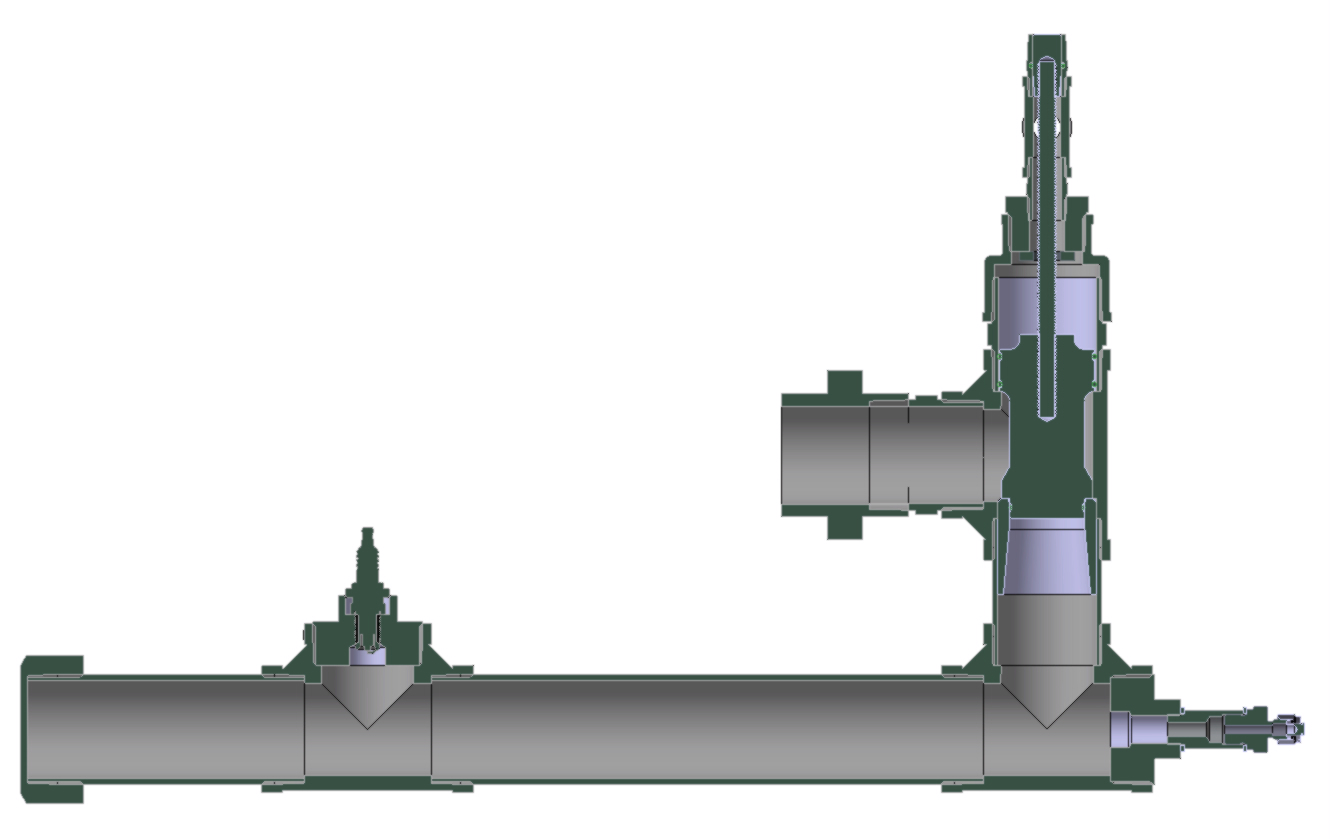

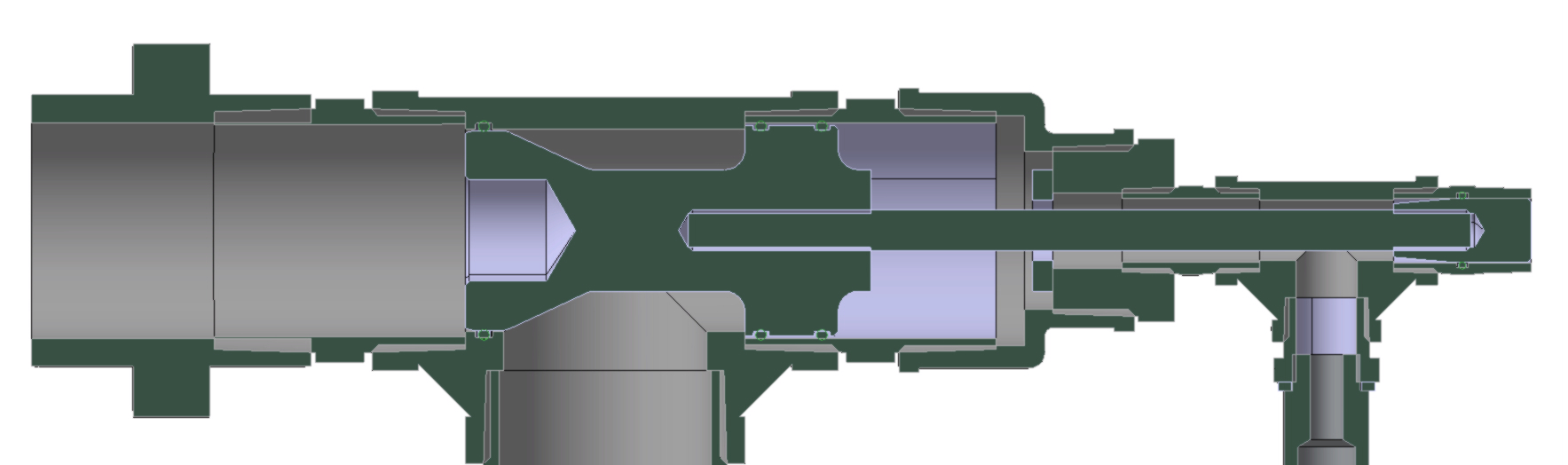

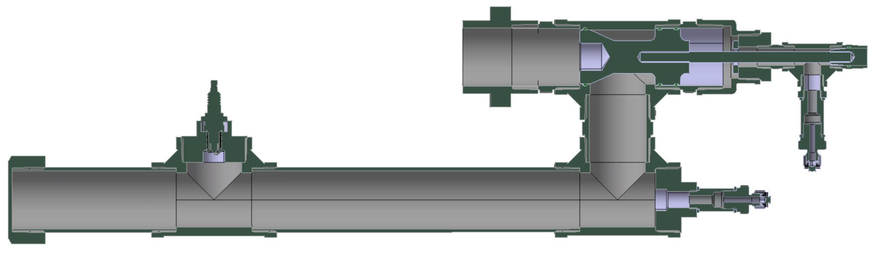

There's something about the orientation of the piston that isn't sitting right with me.
I feel that having a design where the piston moves vertically, essentially sealing the chamber rather than the barrel would be better. As a picture is worth a 1000 words, here we go:
What's the general consensus of the 2 designs featured?
Regards
Stuart
Regards
Stuart
