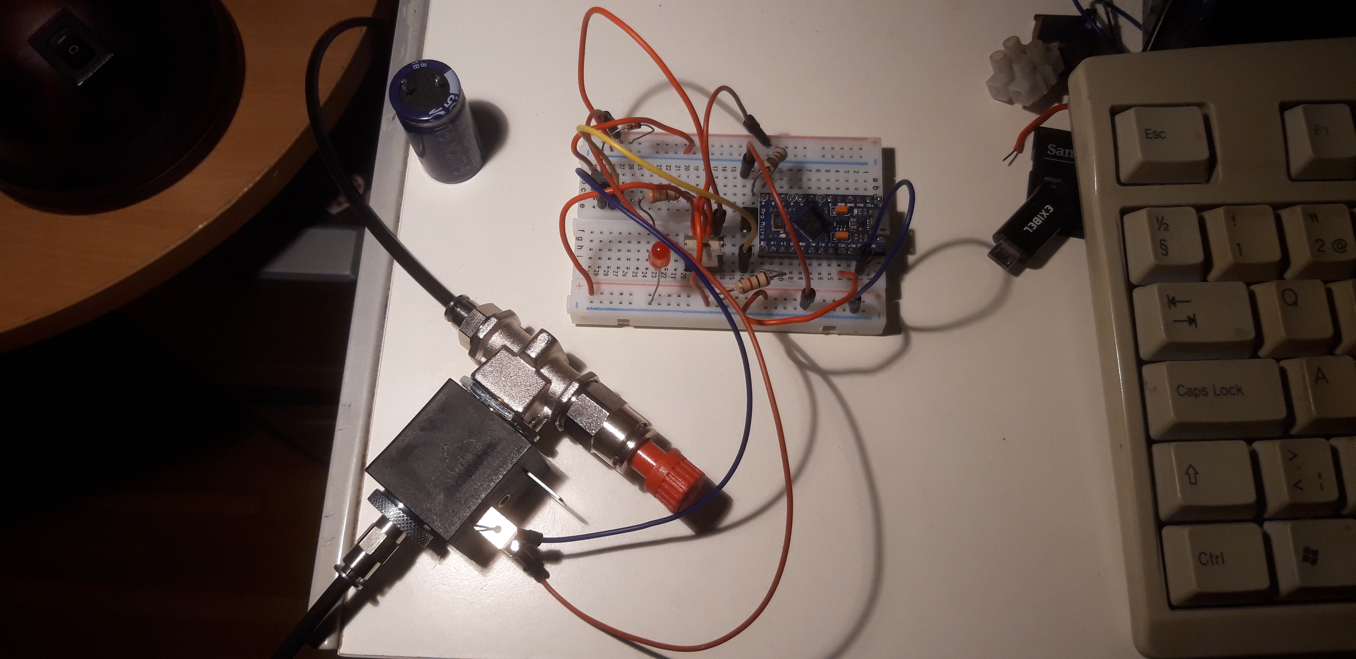

The breadboarded first prototype circuit and the three-way pneumatic valve with plugged port.

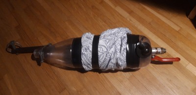

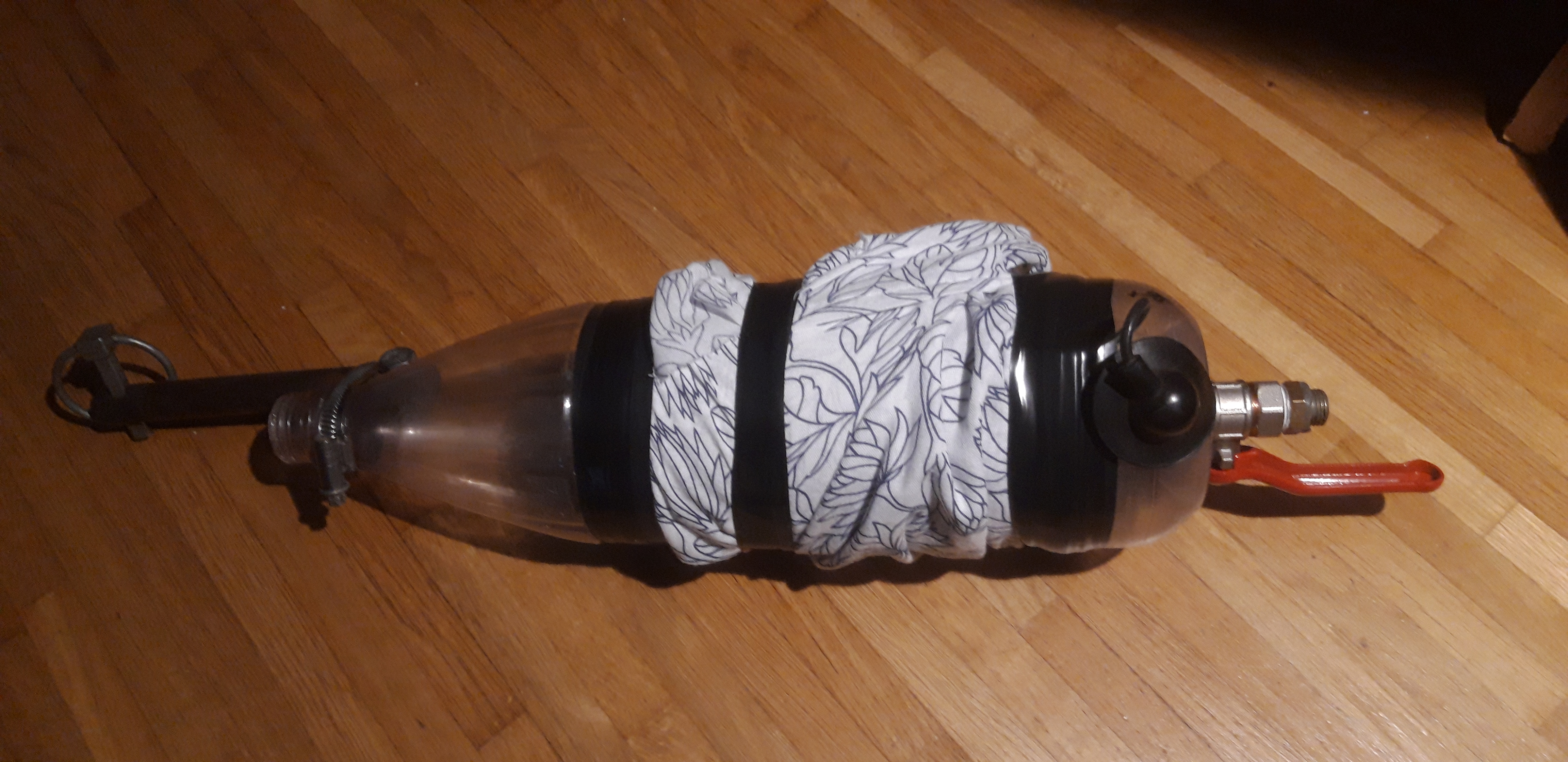

The new combustion chamber with ball valve and ignition circuit attached. Also my big toe.

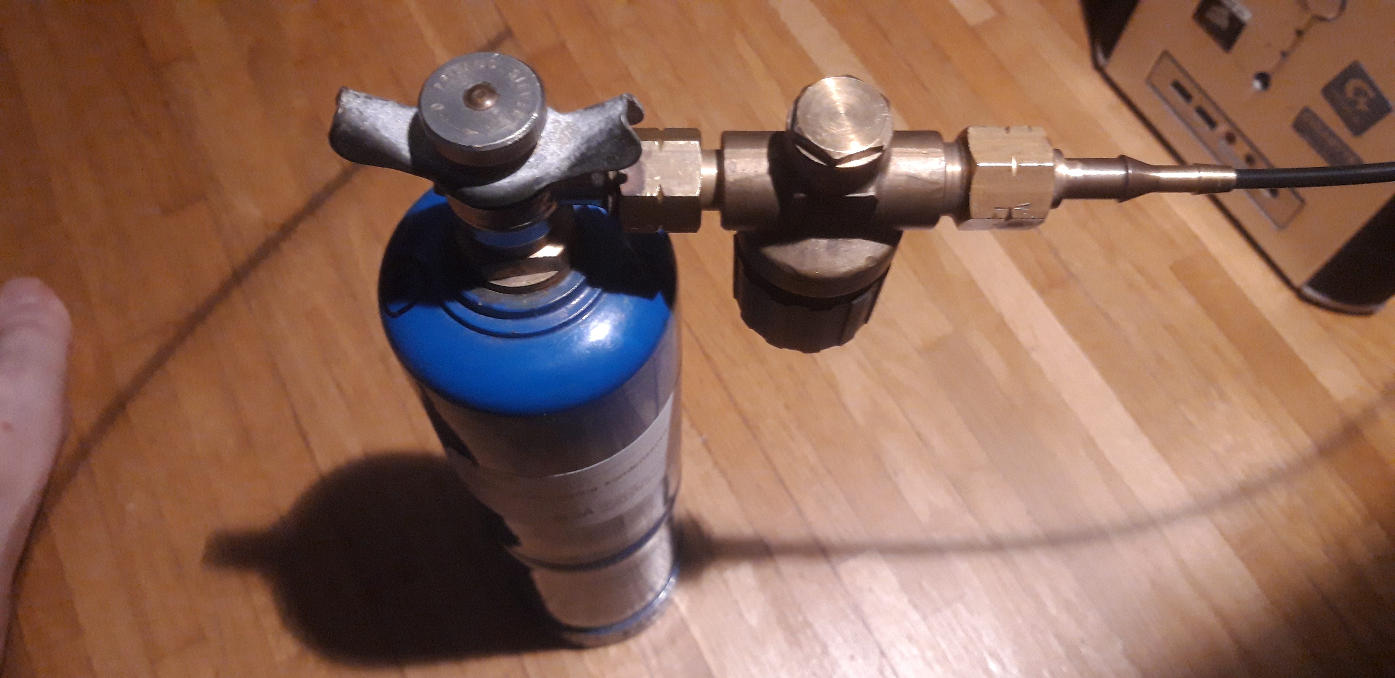

Propane tank and regulator (mounted upside down for space reasons)

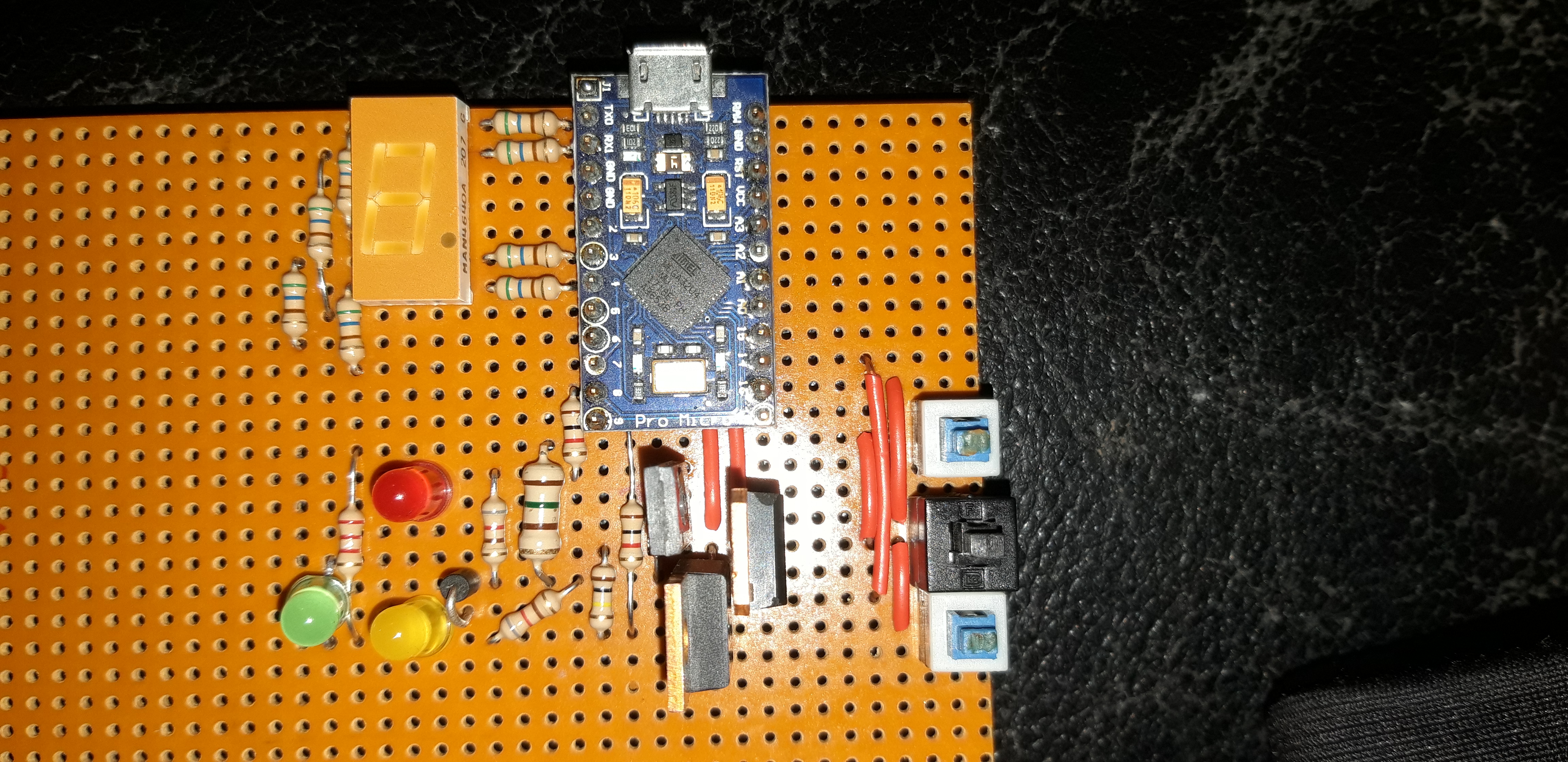

I've tested the low voltage part of my veroboard build (essentially the 7-segment bit), but I haven't connected the battery yet. I need to triple check everything and start out with a lower voltage, because if there is a short anywhere that gives 16V to the Arduino, it's toast.
The 7-segment display will show status and diagnostics with a single number or letter. The colored LEDs are connected to voltage outputs in order to show what they're doing. I may also decide to connect them to analog inputs through voltage dividers, so the software can check what the hardware is doing.
I haven't decided how to enclose the circuit yet, and I may replace the buttons with something else also. It should be fairly rugged, and easy to use, but I don't need it to be operable by others.

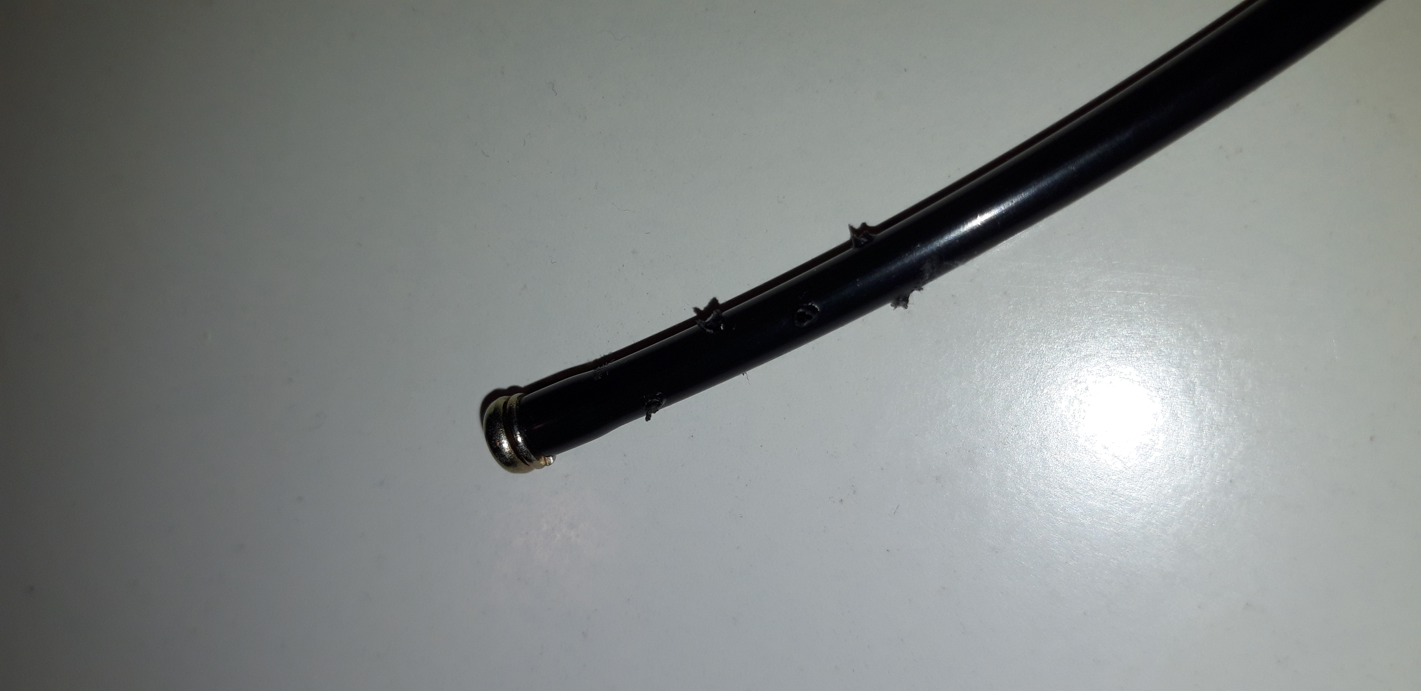

Fuel injector (drilled tubing)

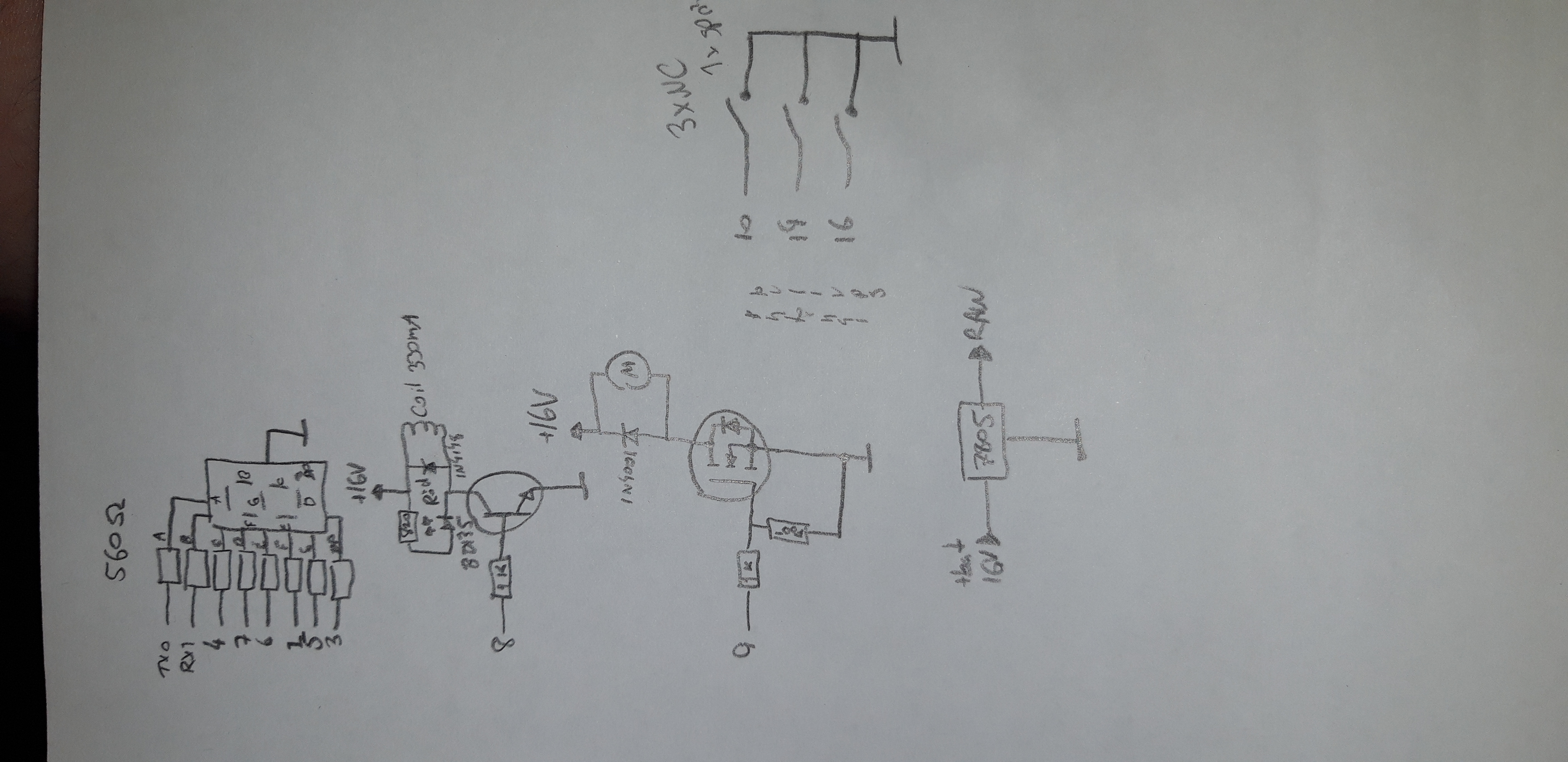

Electronic schemtic of stuff attached to the Arduino. The firing capacitor charger is just attached to the battery, and is essentially a resistor.
The circuit on veroboard. I haven't decided what the small buttons will do, but the big one is for injection. Maybe the small ones wil select different functions for the big one.

Nice job on the circuit. I'm a man that can appreciate the work required to compact something onto perfboard. If you're interested (probably not given the work put into the current iteration) an ATTiny takes up even less space but that's not always a priority.

That's a good writeup covering many fueling scenarios. If you wanted to expand on it, you could add liquid metering and my method (let's call it puff metering). I'm halfway through writing the formulas, but I've been coding all day (the software is done, two hardware bugs were found and fixed, smoke test tomorrow), so my brain is a bit mushy. I'll work on it more tomorrow.
I love perfboard and use it for all my permanent projects. I enjoy the puzzle-like nature of laying out the circuit in a compact manner on paper, trying it out to see how it fits, and modifying as necessary. The transistor cluster (actually two transistors and a 7805 voltage regulator) was a result of this process, and it kept the heat sinks from touching (which they nearly did in my original plan) as they all carry different voltages. I don't expect either to actually need heat sinking. I've left some space for hooking up the analog lines of the Arduino if I want to, and the 7-segment was added more for fun than necessity. About 20% of the code is for that one alone.
I have a bunch of Pro Micros I bought for cheap in order to do projects such as this, and I don't need the board any smaller, but thanks for the tip about ATTiny. It may come in handy for more space constrained projects.
Functionality:
Top button: fuel enable/disable
Bottom button: fan enable/disable
Middle button: execute
If neither fuel or fan is enabled, but action is pressed: prime gas lines. If priming or fueling has been done at least once, purge gas lines
Fan has a PWMed spin-up of to seconds, run time of 5 seconds, and spin down delay of three seconds - all guesstimates.
Fuel priming is three slow puffs (slower speed mainly to give feedback on what's happening)
Fuel injection is 20 100ms puffs
Fuel purge is 30 50ms puffs (prioritizing speed rather than accuracy)
The 7-segment will flash text about what is going to happen when action is pushed, count fan runtime (I'll probably change it to a countdown), or count down gas puffs.
