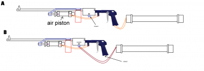

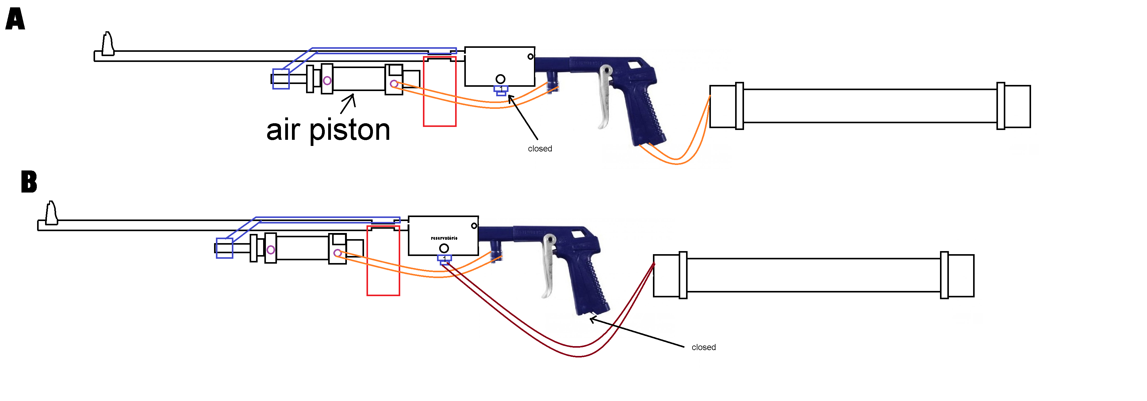

Hello there. I'm planning to make a semi automatic air carbine, but I'm not familiar with QEVs and air cylinder pistons, so heres two questions:
1- can I use this style of blow gun to divert pressure to the pneumatic pistol and thus push it forward? Or can I only do it with a solenoid 3 way valve?
2- can I connect the reservoir directly into the blowgun handle like in example A by closing off the QEV air entry (marked as 1) and putting a shredder valve at the back of the reservoir to fill it up from there? Or would it need to be done like example B?

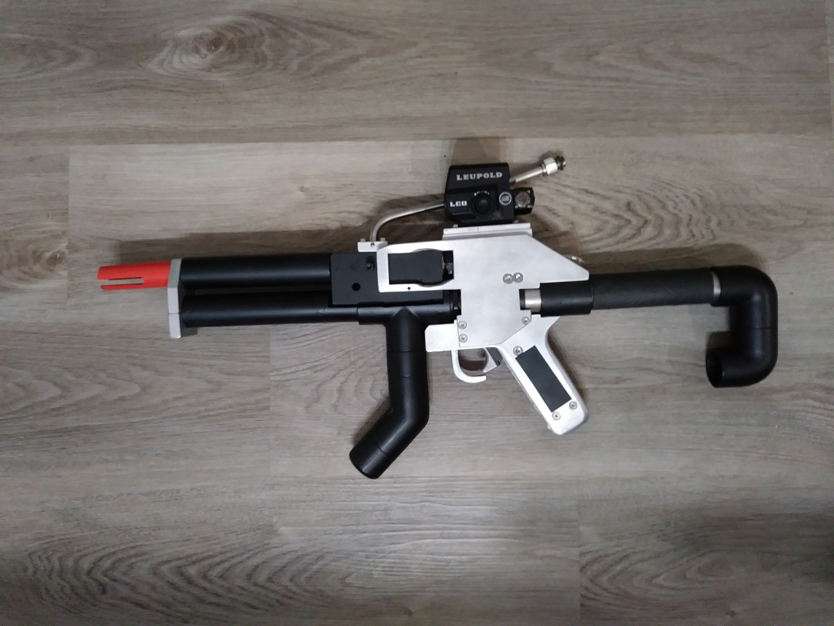

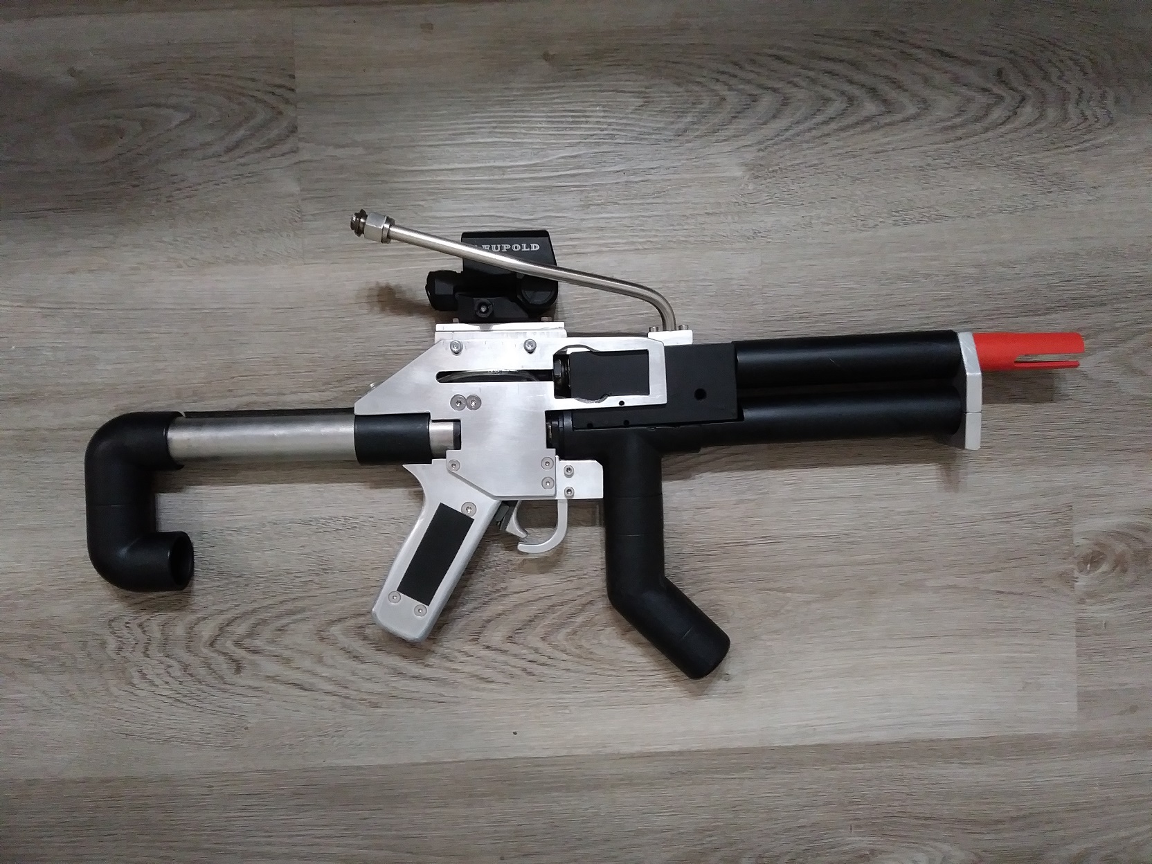

I did the piston thing with my 10mm, it ran off 2 valves, was pretty complicated for what it did but worked great.

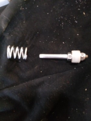

This turned into a semiauto by making a simple spring loaded piston, I'll find some pictures. If I was going to build another semiauto I would do this again.
viewtopic.php?f=29&t=26658
This is how the piston works, the block is aluminum.
I made it from a piece of nylon and a bolt

You may get away with no bolt at all. I have done that multiple times. Just seal the magazine with the barrel so that no air can escape. This makes the whole thing more powerful and simpler
