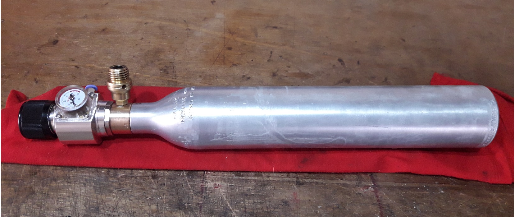

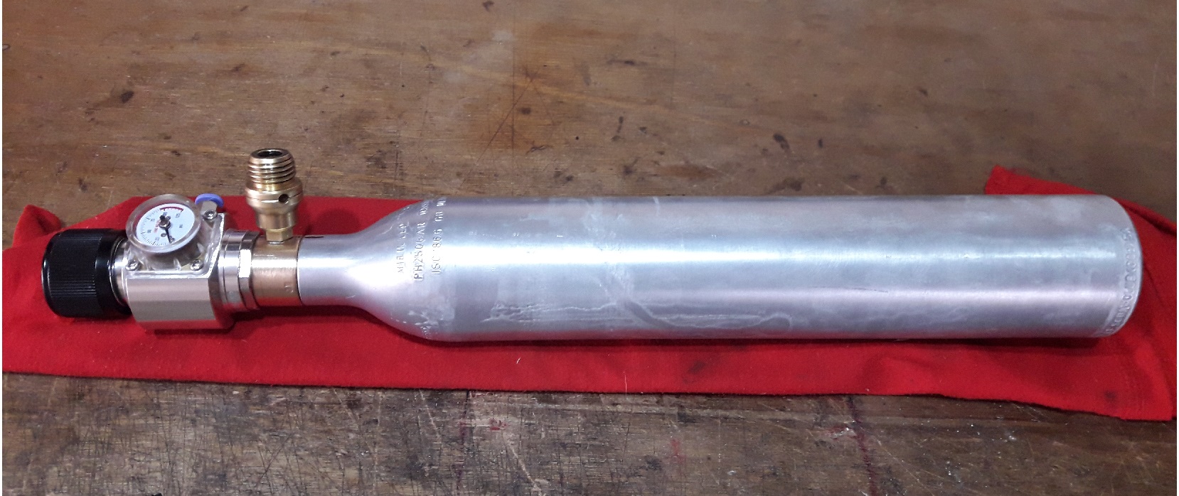

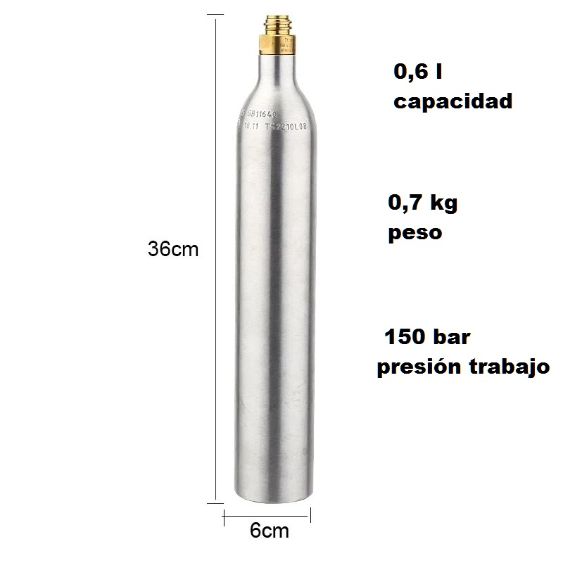

Testing this "sodastream" aluminum co2 canister as a low cost compressed air tank. 0.6 liter internal capacity, 250 bar factory test pressure, and 166 bar working pressure, lightweight. The regulator is for co2 from 0 to 7 bar, and supports about 150 bar at the input. Normally I inflate it to 120 bar to shoot my hybrids. It weighs 1.1 kg with regulator included.
It has a threaded check valve that fits my high pressure pump.
