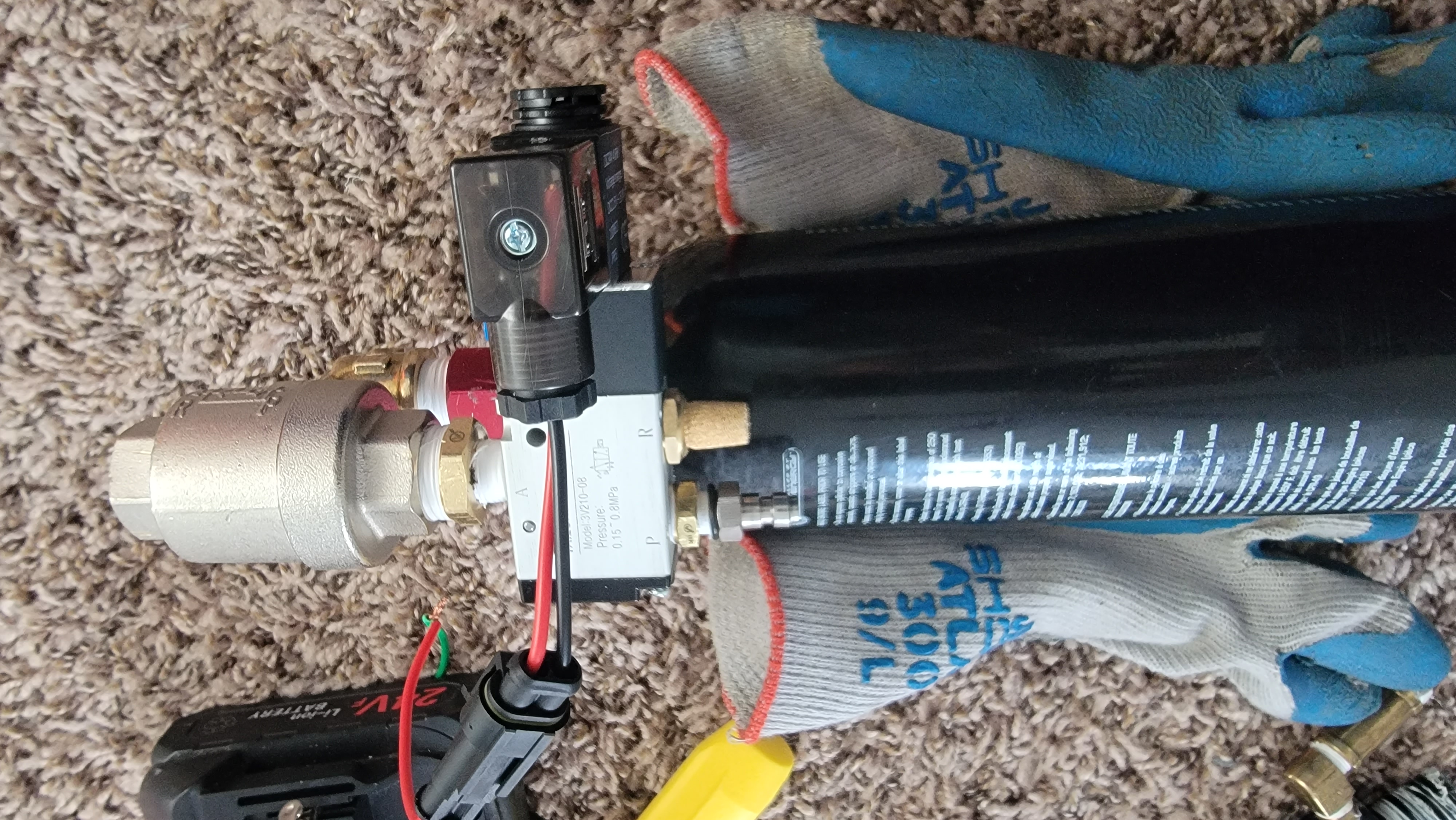

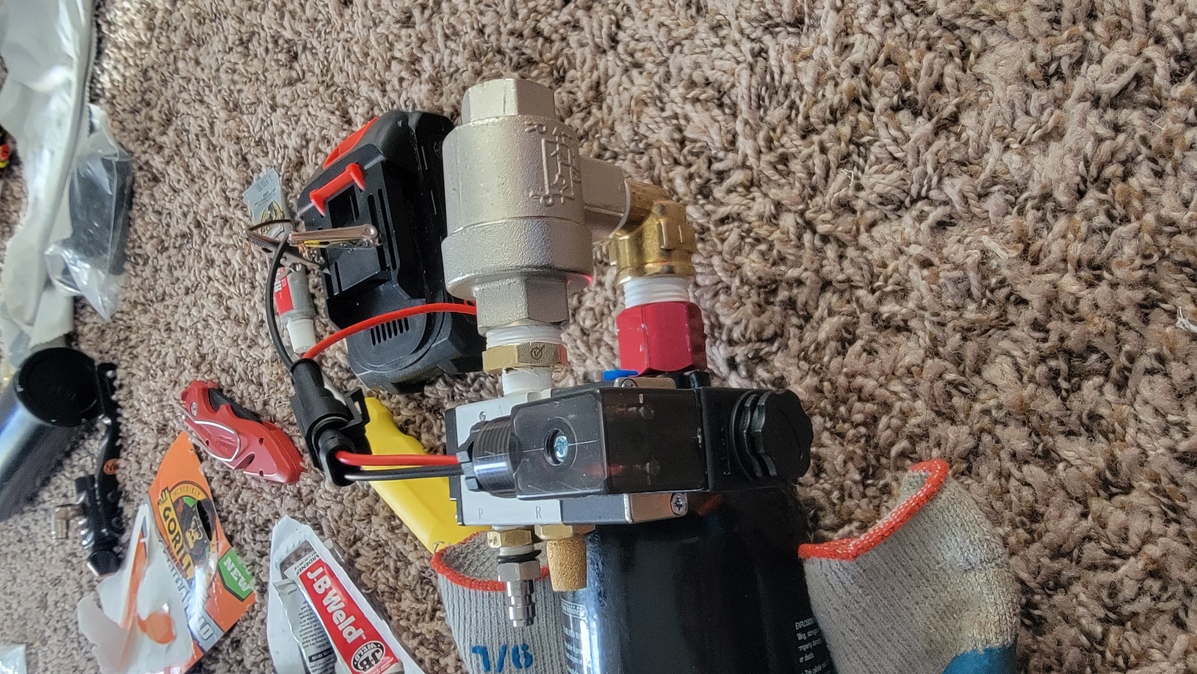

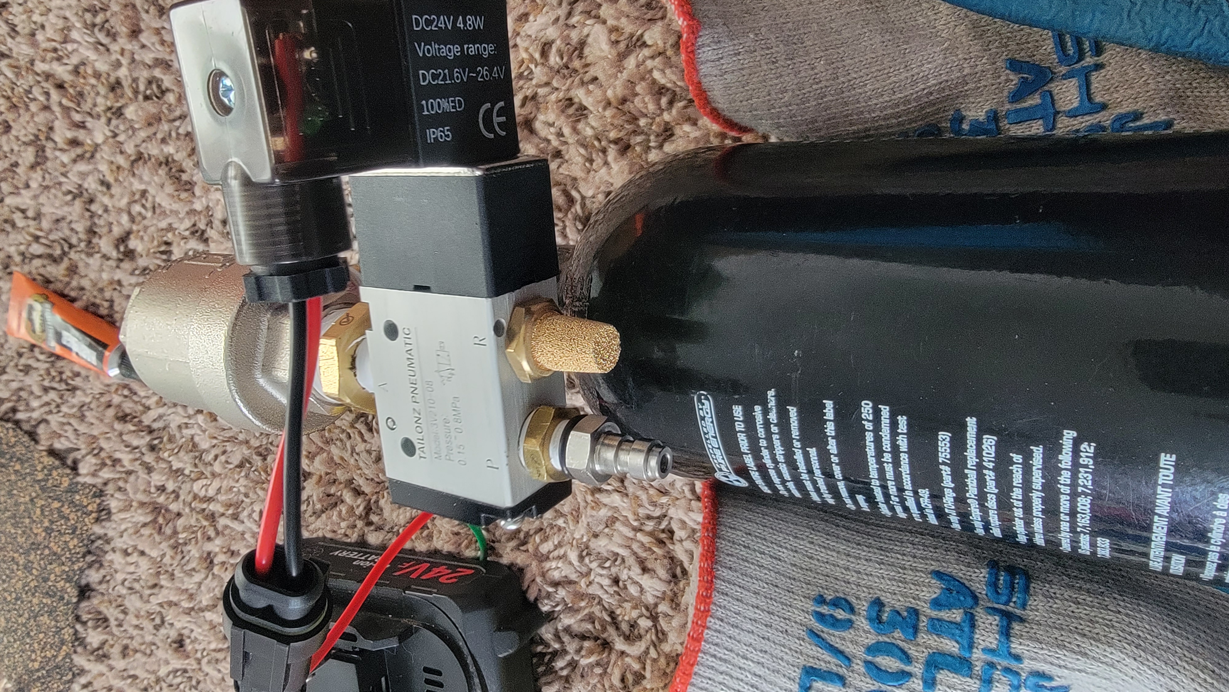

Hi I'm having trouble with a solenoid valve for a qev cannon! The issue is the valve is working but in the opposite way I need it to. So when the trigger is pressed the valve is activated and allows air to flow through the valve past the qev and into the fill tank, when I release the trigger it then closes and dumps the air from the fill tank through the qev. I need the opposite of this action. Need it to fill the tank automatically then with pressing the trigger shut air off and activate the qev dumping the fill tank! Did I get the wrong valve and solenoid or can the action of the valve get switched? Any help would be greatly appreciated! Pictures of current configuration

Welcome to the forum!
Assuming you have a two position three ported valve, the ports should be as follows:
P - inlet
A - outlet
R - exhaust
Depending on whether the valve is normally closed or normally open, gas can flow from P to A when not energized and from A to R when energized, or vice versa.
From what I can see in the images you've shared, you appear to have hooked it up correctly, I'm assuming the nipple on P is connected to your main chamber and A is connected to the QEV pilot.
If that's the symbol on your valve, I believe it could mean that the valve is normally closed, in which case you would have to switch P and R.
