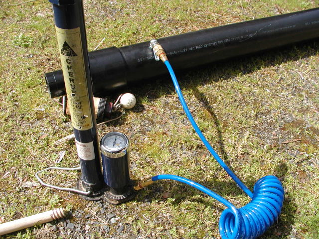

For my field use, I use a high volume hand pump and prefer to shoot the small tank cannon. When we have a big bunch of guys around, they can rotate pumping while building anticipation. Gotta watch the smokers, they tend to be beat at 20-30 PSI while athletes take it on up to 80 PSI.

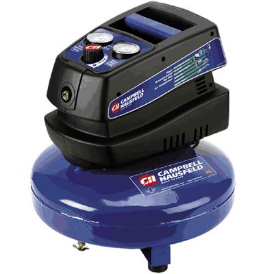

Some smaller nailer compressors will run on a larger inverter. My Prius has a 1,000 Watt inverter and will run a little compressor or a fridge compressor. Other options are a gas generator or gas compressor.

Small compressor I am considering to run off the car inverter.

Hand pump
Hand pump
