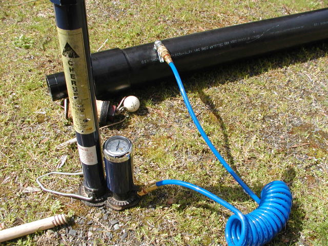

Manual- a track pump as mentioned before is best.

For my field use, I use a high volume hand pump and prefer to shoot the small tank cannon. When we have a big bunch of guys around, they can rotate pumping while building anticipation. Gotta watch the smokers, they tend to be beat at 20-30 PSI while athletes take it on up to 80 PSI.
