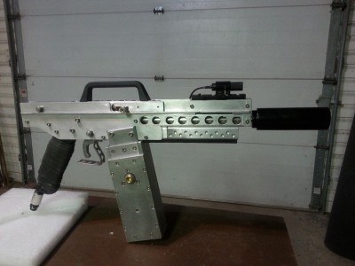

From what I can tell, it's a variation on the detent BBMG using a flexible seal as a detent.
I had made several experiments along these lines, here is one of them in 3mm caliber.
One of the issues I encountered is that the following BB plugged the barrel too quickly, so the air was blocked off before the first BB left the barrel.
My solution was a blocker mechanism that prevented the next BB from being fed until the first BB had left the barrel and pressure in the ammunition chamber had dropped.
In the case of this design, in order to solve this issue there appears to be a bypass line in the magazine/firing chamber that I've highlighted in red below:
All in all it looks like very good design and execution, especially the removable magazine, and it appears to have been built in the spirit of the Caselman Air Machinegun:
