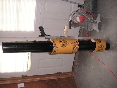

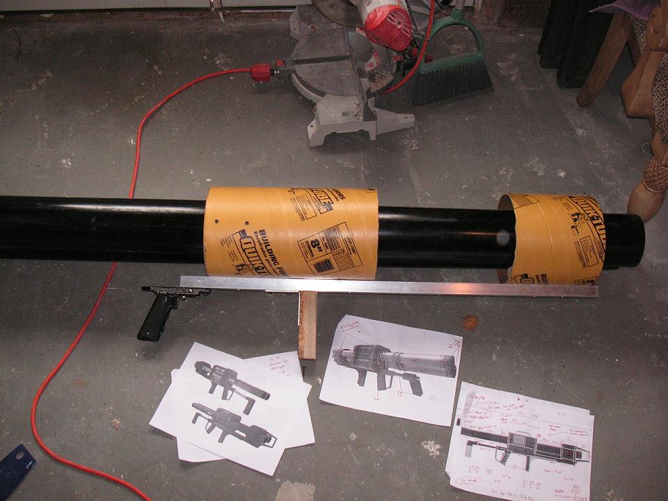

Basic construction is complete! Details, paint,front grip,shoulder pads,and propane injection, as well as other small mods(chamber fan,spark strip,etc) are to come.
I do have one safety concern. I used all 3" fittings, and ground the little tabs(that are supposed to prevent you from doing this) off so i could fit them inside the 4" pipe. I did clean and glue the inside,as well as the fittings, but I'm concerned that its not a good enough seal, or possibly not enough glue. I cant get the pieces out as there already glued(possibly only partially) and I'm worried that it could cause problems during firing. I know the pieces hardly fit down the tube,and make a very good seal, but I'm not so sure that when i shoot it the barrel reducer isn't going to come out of the front. The back caps are glued much better as i can see it closely as I'm gluing, but i think ill add a couple screws through the 4" into the adapters so they dont slide around if somehow they become dislodged.

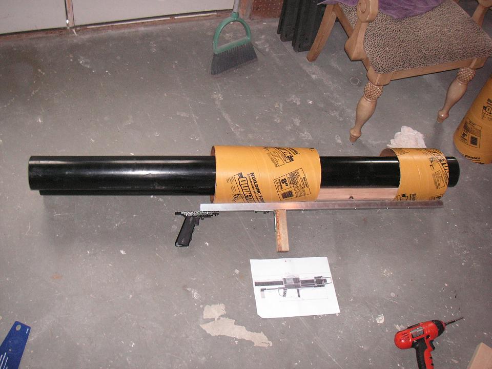

without more delay, here are the pics as it lays right now

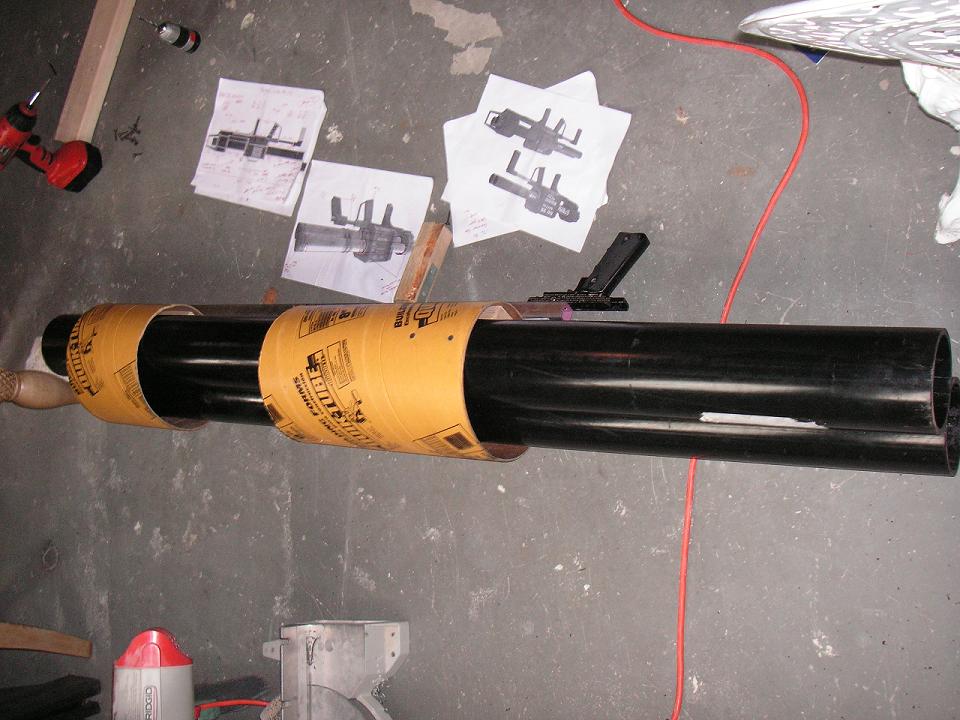

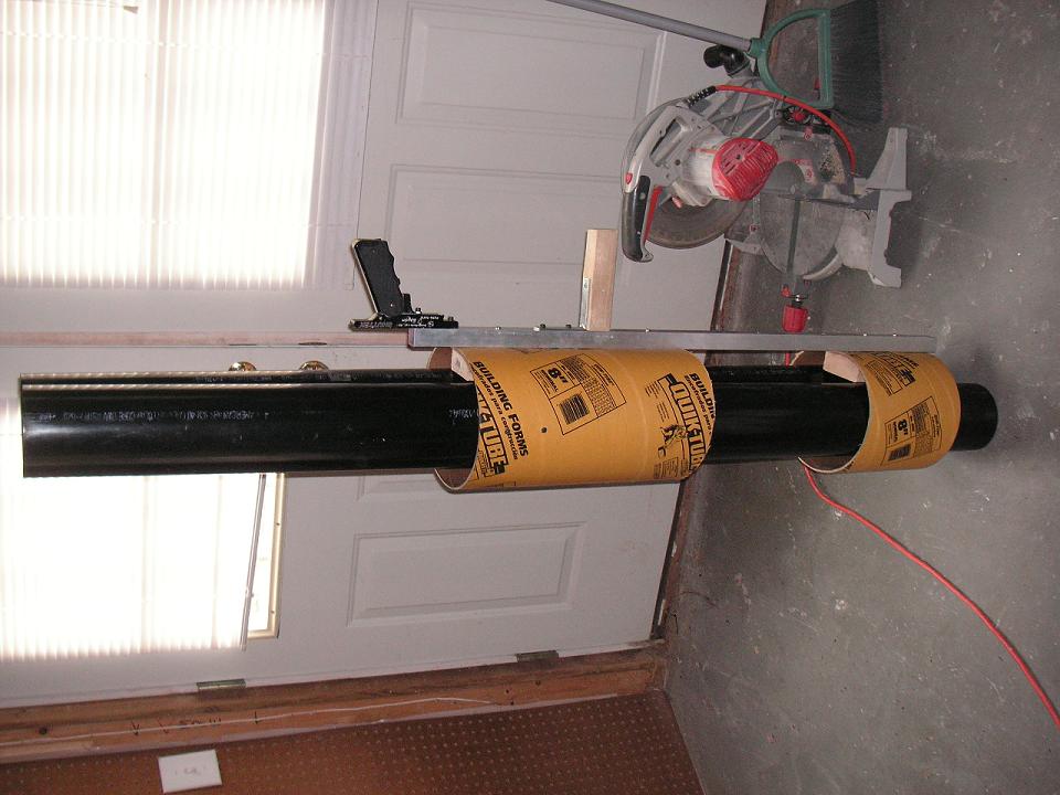

heres a few more pix after a little more modification. I cut the wood inner lower receiver so you dont see it between tubes, and screwed it all together, so its all one, big, spud gun at this point. it still doesn't have propane injection or any ignition source(i have spark strips made, just not going to install until i have ignition ready)
Need to find a bike pump or something for the front grip, figure out how to build the big middle box. i was originally going to do it out of cardboard but im not sure now. i may not do it for a week or so. I gotta clean and paint it after i get the third grip and a few more parts. thats what will really get it looking right

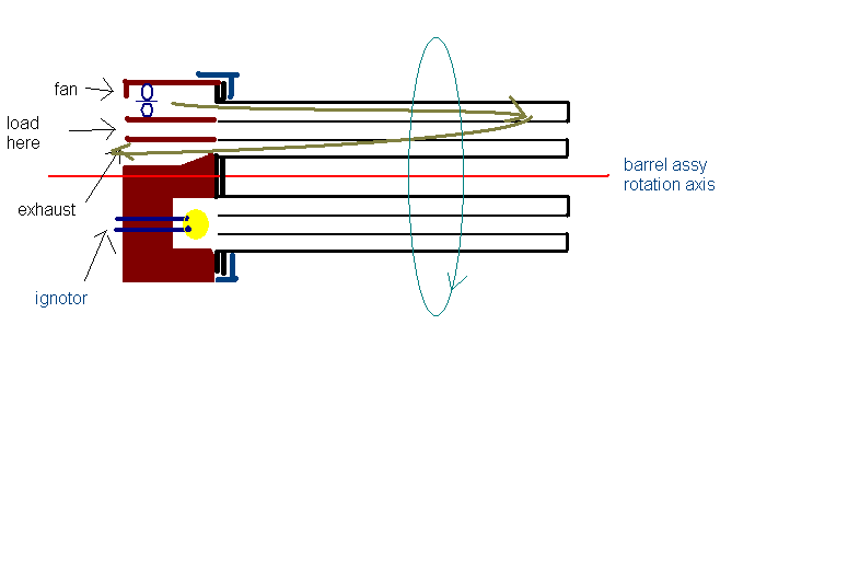

Hi,
Just skimmed over the suggestions,
Why not just keep it a combustion for construction simplicity, and make it a dual combustion coaxial? No pistons.
OK I see the problem: Getting the chambers vented.
OK here is a suggestion. It looks almost impossible in this form, but you will find another...
The two coaxial chamber/barrels are mounted in a rotating assembly. On the left is the "big box" which is getting hard to construct... There is a big flange, holding the barrel assembly. The barrel/chamber on top is getting vented by a fan and loaded (and fueled; find out something). The barrel/chamber in the bottom position is ready for firing.
I know there are 2 major problems: Constructing that box, and dealing with the pressure wanting to tear the barrel/chamber assembly off the box when firing. Well, and getting the barrel/chamber assembly to rotate smoothly. So it's just for inspiration; not refined to practicality.
You know, if you keep your eyes open for a solution for each problem everywhere you go, you will eventually find a solution for each problem. But maybe it will take some time.
EDIT: Oops I didn't see you decided on a design already and had started construction. What you are doing looks more realistic anyway so keep working on it
Regards
Soren
