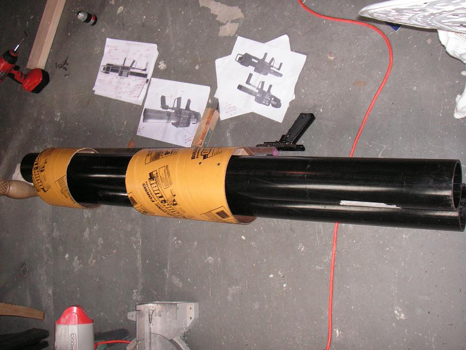

UPDATE: Construction has begun. The chambers and barrels are in place, as well as both of the big tubes that house them. Glue is drying as we speak. Tomorrow I add lower receiver, 3 grips, ignition, possibly propane injection, and the big box
ill try to get some pix up tonight. its pretty sweet already. the shadow looks awesome!

Basic construction is complete! Details, paint,front grip,shoulder pads,and propane injection, as well as other small mods(chamber fan,spark strip,etc) are to come.
I do have one safety concern. I used all 3" fittings, and ground the little tabs(that are supposed to prevent you from doing this) off so i could fit them inside the 4" pipe. I did clean and glue the inside,as well as the fittings, but I'm concerned that its not a good enough seal, or possibly not enough glue. I cant get the pieces out as there already glued(possibly only partially) and I'm worried that it could cause problems during firing. I know the pieces hardly fit down the tube,and make a very good seal, but I'm not so sure that when i shoot it the barrel reducer isn't going to come out of the front. The back caps are glued much better as i can see it closely as I'm gluing, but i think ill add a couple screws through the 4" into the adapters so they dont slide around if somehow they become dislodged.

without more delay, here are the pics as it lays right now

heres a few more pix after a little more modification. I cut the wood inner lower receiver so you dont see it between tubes, and screwed it all together, so its all one, big, spud gun at this point. it still doesn't have propane injection or any ignition source(i have spark strips made, just not going to install until i have ignition ready)
Need to find a bike pump or something for the front grip, figure out how to build the big middle box. i was originally going to do it out of cardboard but im not sure now. i may not do it for a week or so. I gotta clean and paint it after i get the third grip and a few more parts. thats what will really get it looking right

I'm working on the middle box. its turning out to be a real P.I.T.A.. Ive tried 5 different materials, but cardboard is the only thing that i can cut with the tools i have and to the right shapes. i think I'm building the middle square box out of a box just cut in 3d out to that shape.its a real challenge though.

Update: Central box is getting closer to done. I ran an ignition for one of the barrels, using a 15 spark gap(piece of a blank pcb) but for some reason it didn't work. so i had to redo it to just bare wires temporarily. also the cameras didn't work so i switched back to a bbq ignition. i fired the first shot yesterday... just used hairspray to try it out, and performance was pretty dismal, but i think with the fan installed, propane injection, and the spark gaps all right it will be better. Ill paint the whole thing when the middle box is done, and post more pix then
