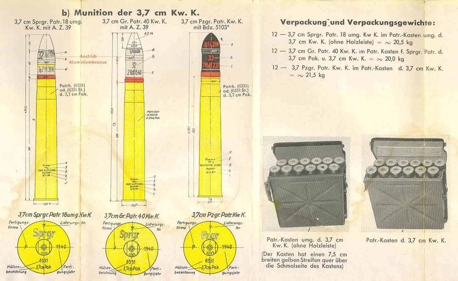

I have some projectile design for my pak36 like:
I think I have more stability with a warhead rather than a sphere. after I could be wrong, I did not do any tests :D

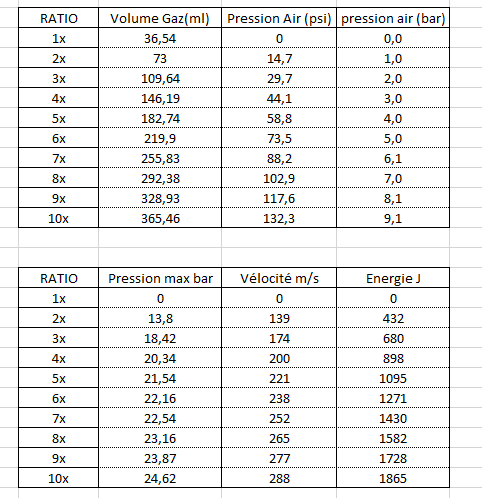

I have the results of my calculs for the power. However I ask a question, in the simulator, I put a tensile strength of 10 bar on theburst disc. How to obtain these 10 bar of resistance by adding layers of aluminum foil and by doing tests or can we determine the thickness by calculs ? :D
these results seem good to me with the characteristics of my combustion chamber etc... and using your method with the syringe ;)
Normally we do trial and error. Sometimes tightening the cap to a different torque will change the burst pressure.
What is the volume of your chamber?

To know the approximate necessary force at which its rupture disc breaks, you must assemble the disc inside the system and with a rod of the same diameter as the area exposed to the explosion pressure, gradually tighten and measure the force with a balance. So you can determine at what force it breaks. You already know the collapse force, the area of your rupture disc exposed to high pressure gases, and you can deduce the necessary pressure.
It is important that the rod you use fits snugly into the channel that communicates the combustion chamber with the rupture disc.

I have 1216,5ml for my combustion chamber
Not stupid, I will try this principle during my tests. Anyway, I would porgressivment increase the thickness of the burst disc with aluminum foil to make it work well.

Looks like you will have to use more than 1x mixture, otherwise your chamber to barrel ratio will be too small. Do you know what your designs' chamber and barrels volumes are?

It's a shperic form, go see the diagram in the first step of on shell. ^^ Yes I will need a mixture of at least 2 or 3 to start.
