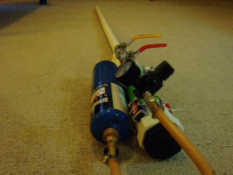

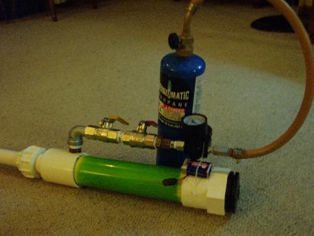

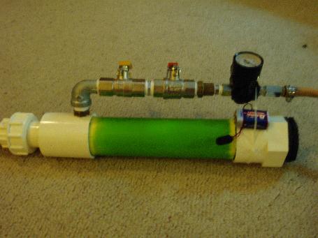

This is my mini hybrid and my first hybrid cannon.It is still in a stage of construction,but the only things required are a good ingition source and a shrader valve for adding the compressed air.
The gun sports at the moment propane injection a chamber fan a union for the burst disks.The majority cannon is made of PN18 pipe the barrel is PN12.The chamber is 50mm and the barrel is 25mm,using a C:B ratio of .8:1.
This gun is going to be fired at 1.5X mixtures and maybe the odd 2X mixtures.
i have a goner!!!! i cant wait till i shoot this beast!!!! 4 weeks and counting

Looks very good! The only problem you might run into is getting the propane pressure just right. You need to take the volume of the elbow and the plug into account. Good luck on your first test!

Thanks guy,and spudstuff i have metred the propane precisely,which measns i filled it with water to find the eczact volume. The propane is at 35psi because of the small chamber size,but still the metred section of pipe is only 6mL which is a nipple...
