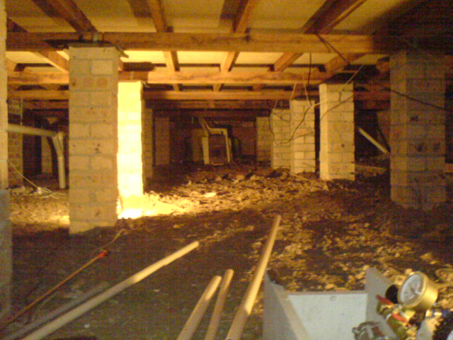

do you remotely detonate it from upstairs, and how loud is it
Have you done any damage shots yet? What is the estimated burst pressure of the chamber? What kind of ball valves are you using to separate the meter from the chamber? Most brass ball valves are only rated to 600psi.
P.S.- I love how the gauge's needle is bent from the pressure spike.

Jesus you would want some hearing protection in that shooting range!You would have no ears drums left after a few shots.
Nice cannon,the chamber is Aluminium right?Is there any powder residue left on the inside of the chamber after shooting?Because usualy a layer of oxide on the chamber.

Homedepotpro, I dont fire it from upstairs, and its very loud, but the brick walls and pillars seem to muffle the sound alot, i fire all day and it bothers no neighbours or anything and isnt loud at all to anyone standing in my backyard
DYI, I have only been firing some lightweight pine wood slugs, they punch through 5/8" chipboard easily at 5X +, the chipbaord is laminated and highly compressed - its not shit stuff. I did some figures to estimate the burst pressure of the chamber a while ago, but i simply have forgotten / neglected to re-do the calculations - i think its over 10000 psi (but i really do forget anything specific). The chamber was designed over-strength to be better equipped for possible detonations. The brass ball valves are only the standard ones, i think 600psi is what they are rated too, as i said before, in its current state all but the chamber is considered sacrificial - i dont trust anything but the chamber not to explode (as stupid as that may sound) So i like to be in a safe position when it is fired. Once it is in its complete stage i will run ball valves with around 2000psi rating atleast. Another weak point is the lever coupling, it is aluminium, it will be replaced for stainless for the main reason that i trust stainless more than aluminium, but that part of the gun will remain sacrificial unless i decide to machine a complete flange system myself at a later date. I also love how the gauge is damaged, its my fave pic of the gun, and really gives you a sense for its power
rna_duelers, I havent checked for that as of yet, ill let you know when i do (gun is still under the house, i get home from work and cant be bothered crawling in there to unhook it all and crawl out with it). The loudest shot so far was the one that destroyed the barrel, but i dont wear hearing protection at the moment - I think if i was located down range of the gun it woudl be painfully loud though
