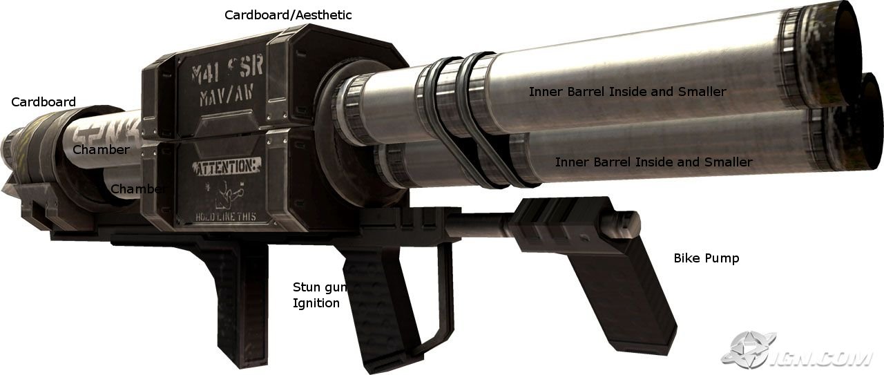

Heres a labeled picture so you might be able to have a better idea on what im trying to do

I can see a coaxial made out of that...
For the metering system, maybe you could put the propane can in the box, then have the ball valves and stuff on the bottom, out of the way but still in easy reach.

thats what i was thinking. if i do end up doing metering it will all be inside the box, and then the valves would be either on the back or hidden. that would completely eliminate the problem of fueling it,and that combined with nerf rockets would keep it looking great and highly functional without too much extra stuff, or having to take it apart every time to refuel.
Can u draw and ms paint picture or modify the blue and black render to show me what your suggesting with the coax? i know how and have seen coaxial guns but i don't understand how it will work in this application

this is def coaxial gun. use 4" pvc with 2" running down the middle, supported buy altered bushings or reducers. Have a cleanout on the end for loading/venting. A propane meter system should fit nicely inside the middle box.
Really what you are gonna have here is 2 identical coaxials joined together in one sweet package.
Is a stun gun even necessary? Id just put 2 BBQ ignitors (one above the other) on the handle, running to a spark strip in the respective barrels.
