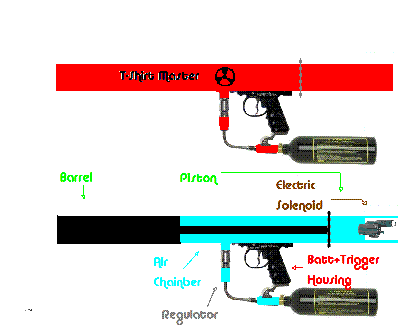

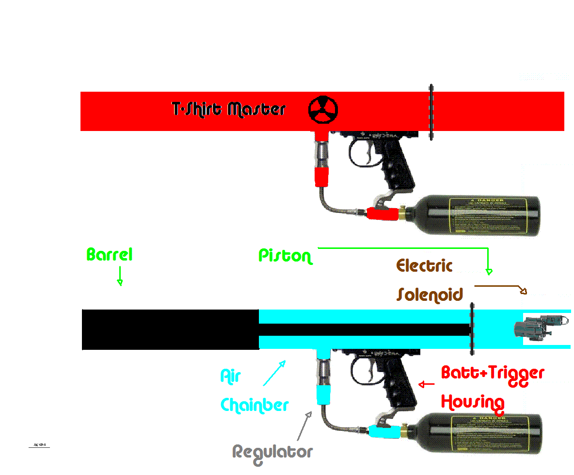

Build something like this...

frankrede wrote:Great googlay mooglay!
Thats a beast!

I'm fine with pushing a button. So Can somebody list what is needed to build this?
Thank you!
