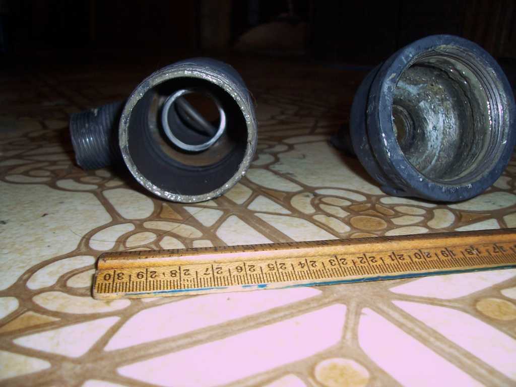

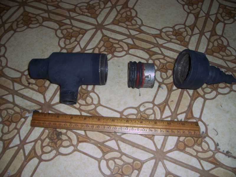

Getting to the point... I put a coat of primer on the valve and found this after it had dried.
A crack had spread around the reducer from the piston impact. I put a big heavy spring in there as a bumper, but it did no good. Unless "good" is being smashed into a spring-shaped pancake.

The crack goes all the way around...<br />Easy fix, but it probably would have hurt a bit if it flew out and hit me.

With some interesting ggdt usage, I figured that the piston (~6 oz) accelerates to over 150 fps in the 1.5" of travel it has currently. With figures like that, I'm not sure if adding additional travel would help even with a bigger spring to slow it down... there's just too much energy there.

Is that a metal piston? A lighter piston would hit the endcap with a good deal less force.
Secondly, I think I see a scar on the endcap where the corner of the piston hit it. I am prone to think that the piston hit the endcap directly.
Any bumper is better than no bumper; you might try a ring of polyethylene or rubber. (solid rubber)

Why I made it? Well, does anyone else have one? To my knowledge there are only 2 in the world (galfisk has the other one). BTB could easily convert one of his guns to work as a hybrid, though.
And it isn't necessarily less safe, I just haven't figured out how to control it yet :D
I'm guessing if I had done 7x the results would have been similar, but a little
worse. The crack doesn't go all the way through the metal, it's just on the outside, so I don't think it would have completely separated. 8 or 9x would have probably done it though.
I'm gonna try a bumper made of rubber next, unless someone has a better idea. I managed to find enough fittings to repair it, so no trip to the hardware store for now.
