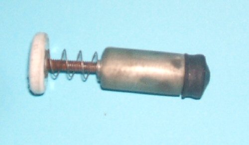

The prototype's well underway, should be ready for testing soon. Here's the valve with the floating element spring loaded (though this will likely be removed to allow for greater valve opening time) and a syringe seal making sure it's airtight - I hope to give you results, whether positive or (yes, MrCrowley :p) negative, within the next 24 hours :)

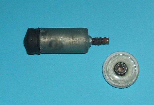

The whole piston is cast out of epoxy, with a hollow section made of aluminium tube to allow the bolt up/down movement.

ALIHISGREAT wrote:t looked kind of metallic... but i suppose it could be metal epoxy
That's 'cause the aluminium tube shows under the transparent cast.

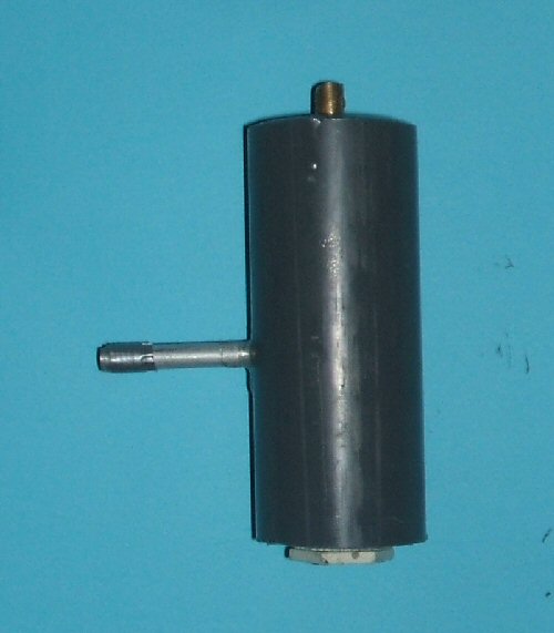

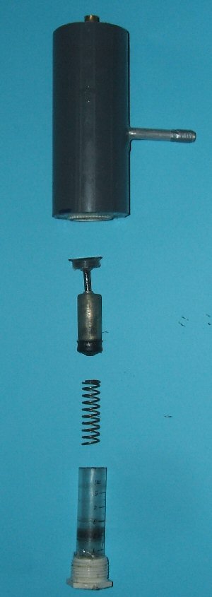

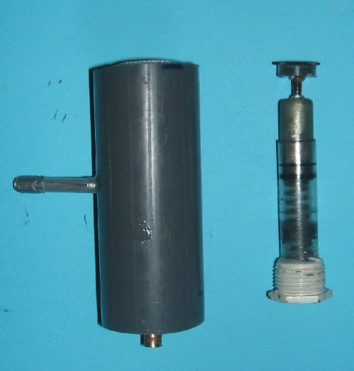

Seasonal drinking aside, the prototype's finally ready for testing :) sadly it's too late now to fire up my compressor, so it'll have to wait till morning. until then, here's what it looks like, pretty much as per the animation. I decided to make it removable to allow for tweaking and maintenance.
Testing in a few hours, which will be met with whoops of unbridled joy, or a profusion of blasphemy most unbefitting to the seasonal theme :?
I'm pretty convinced about this design, if this particular prototype doesn't work, I have some modifications in mind that should get it to function.
floating piston unit assembled in cylinder and chamber.

"exploded view" of parts
assembled unit
assembled unit
