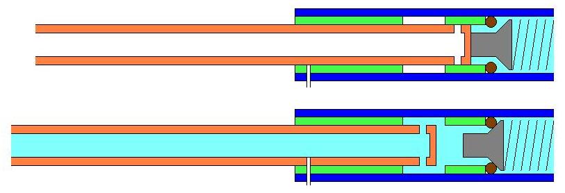

I was looking at the internals and evrything and I just cant figure out exactly how it works... If i understand, when you press the trigger it realeses the barrel (the hammer) wich is pushed by that spring and hits the valve, this realeases air in the barell, But i cant understand how the barrel is pushed back into place.
And also, how exactly does the trigger work?
Thanks in advance
Antonio
Posts: 508
Wed Jan 09, 2008 6:22 pm
nsane-spuds wrote:I was looking at the internals and evrything and I just cant figure out exactly how it works... If i understand, when you press the trigger it realeses the barrel (the hammer) wich is pushed by that spring and hits the valve, this realeases air in the barell, But i cant understand how the barrel is pushed back into place.
Thanks in advance
Plz check my new posted gif for the answer. Hopefully it makes it all clearer.

I was thinking how it could be possible to acomplish full auto with your desing while keeping it as simple as possible and I came up with this... What do you think?
I forgot to draw the spring that pushes the barrel...
