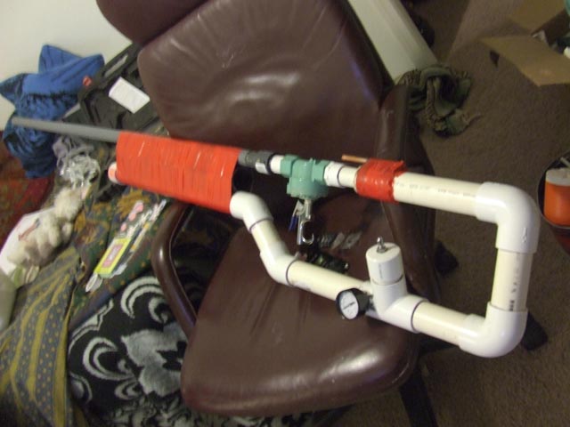

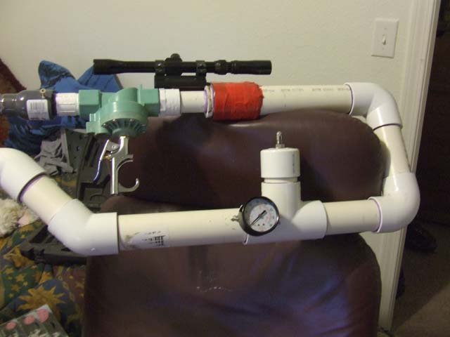

So this is my newest effort. I don't have a name for it as its not quite done yet (still gotta paint it and replace that ugly tape with something more badass). It is about 6 foot 8 inches tall. The chamber includes 5 foot of 1 1/2 sch 40 pvc and a bunch of fittings. the barrel is 1/2 inch by about 4 foot, not sure the type of pvc, but it is pressure rated (said 318 psi on the side). It is much thinner than sch 40. I used it because it fits marbles and as a barrel it doesn't hold much pressure. I sleeved the barrel with some electrical conduit because it was flimsy otherwise. the conduit was just laying around in the garage.
I know the chamber size is overkill, but I don't care. I use a big and fast compressor and air is free.
The breech loading mechanism is something I have seen on these forums in a few threads (thanks for the inspiration!). Its a ball valve with a hole drilled in it. Its rated at 150 psi (the lowest rated piece on the gun? whats a 1 inch sprinkler rated at? I have heard people say they take theirs to 160.)
So yeah, I don't know how to use, or where to download that program to see the power I am getting, but I am happy with it. I didn't get the damage pics to the fence behind these items, but most marbles went through the 1/2 inch plywood AND the 3/4 inch pine fence planks.
I know I promised a piston when I posted my last sprinkler valve. I tried to build one and it was a semi-success at best. It was a mini coaxal copper (about 18 inches long) that shot a chunk of spud about 18 feet at best.
So yeah, here she is.

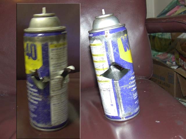

entry and exit wounds to a can of dw-40.

detail of the chamber (most of the chamber at least)
the beast.  the small piece of copper on top is a scope mount.

I like it. Does the barrel have a detent to keep the ammo from rolling out?

Could your barrel be SDR? Did a job on that WD-40 can for sure. They are made from heavier gauge steel. Try a full can of Cambells soup. Nice!

jook13 wrote:whats a 1 inch sprinkler rated at? I have heard people say they take theirs to 160
around 150 - 160 psi
down my way i can get sprinkler valves rated to 250psi though :D
right on, thats what I figured. And I wanna get my hands on one of those sprinklers!
It says pvc1120 on the side of it. I shot a can of green beans but didnt get a pic because I didnt want to bring the drippy can home (didnt have a camera with me). I am going out again today so expect more damage. a video perhaps?
Yup. The screw keeps the marbles from rolling back into the chamber and an O-ring is in there to keep things from rolling out the barrel. Though the marbles are kinda variable in size so the smallest ones still sometimes get past the o-ring
