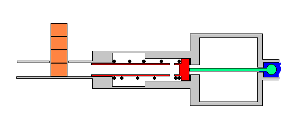

judgment_arms wrote:As for the design posted by Jack, i think you’ve got something there, it basically a hammer valve
The first one is like a hammer valve, but this design is more akin to a pop-off valve, and this is in fact the beauty of the idea - you can delay the rate of fire (ie the amount of time it takes for enough pressure to build up inside the chamber to pop the bolt) by changing the airflow into the chamber, but no matter what this rate is, the valve will always fire at the same pressure, giving you reasonably consistent performance.
One thing you might consider is some form of gas delay mechanism that unlocks the barrel-bolt-hammer assembly once the projectile passes the gas port.
With the pop-off variation there's no need for such a delay mechanism, all you need to do is choke the flow to the chamber.

I'm putting it together slightly differently however, something like this:

Are you going to put somthing on the poppet rod to stabilize it in the firing camber? I don't know but maybe the support could have holes resticting some of the flow to slow the rof.

jackssmirkingrevenge wrote:but this design is more akin to a pop-off valve
Jack, I don’t know, it seems to me that it would get stuck (attached picture shows were/when). You see that main spring has to be strong enough to hold the valve open long enough to build pressure, but week enough to let the pressure close the bolt and fire it. I think that when the bolt/hammer comes back and opens the valve to fill the chamber and then the bolt moves forward, once it gets to where the air is dumped it will drop the pressure enough for it to close, as it closes the chamber volume decreases and pressure builds back up to were the spring pressure and air pressure balance out and the valve becomes stuck.
Am I right?
And Jack, I disagree with you, it’s going to have to be a hammer valve in order for the bolt/hammer to nock open the valve, with all the pressure on the valve holding it shut I don’t think you can just push it open, it’ll take a bit of force.
By the time I got all this typed I noticed that you’d posted a new design, one that looks better, but I’m still seeing the same problems.
I thin' she'll get stuck here

I have a Idea That I think you should use JSR it's about the poppet valve rod you know the green thing it should be a bit longer maybe 1-4th way down the place where the piston travels this lenth should give more time for the chamber to pressurize but maybe the bolt wouldn't be able to come back far enough for the bb to load so the bolt rod might have to be shortened.I think it would work.
Wed Mar 05, 2008 11:14 pm
spudchucker wrote:I have a idea that I think you should use JSR - it's about the poppet valve rod, you know the green thing - it should be a bit longer maybe 1/4th way down the place where the piston travels, this length should give more time for the chamber to pressurize
Ah, but when it comes back it will open the valve before the piston on the bolt has time to seat and thus will perform exactly like the previous blow-forward designs.
judgment_arms, remember that this is a pop-off valve - the spring only has to resist the pressure acting on the small area of the port, meaning it can be relatively weak. One the piston starts to move and its full area is exposed, the available surface area increases by 500% with the dimensions I have, meaning there's 5 times more force to overcome the spring strength - so the hope is it will gather enough momentum not to "hang" open.
It's going to have to be a hammer valve in order for the bolt/hammer to nock open the valve, with all the pressure on the valve holding it shut I don’t think you can just push it open, it’ll take a bit of force.
Well, when the system is at rest, there is no air to hold the valve closed - you need so supply it from a blowgun or ball valve, so it will already be open. For the second shot, the spring will be pushing the bolt back with reasonable haste, presumably this will have a "hammer" effect on the valve. Speaking of which I was thinking of using a schrader for this purpose...

Maybe, but I still feel the valve will just stop. Like I said as the bolt moves forward it’ll get to the point that it’ll open a crack and then pressure will drop allowing the bolt to return which decreases chamber volume which in turn increases pressure, it’ll fluctuate for a second (figuratively of course) and then stop.
Remember, your not going to have to much momentum on the forward stroke as it’s proportional to how fast you fill the chamber, which will be slow due to the fill valve.
