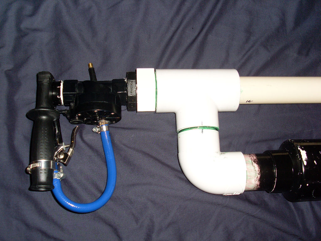

The problems I have now are; I need to find a massive washer for the piston cos the pressure keeps bending the sealing face, I put a very thin washer on that was quite big and the pressure folded it in on itself after one shot

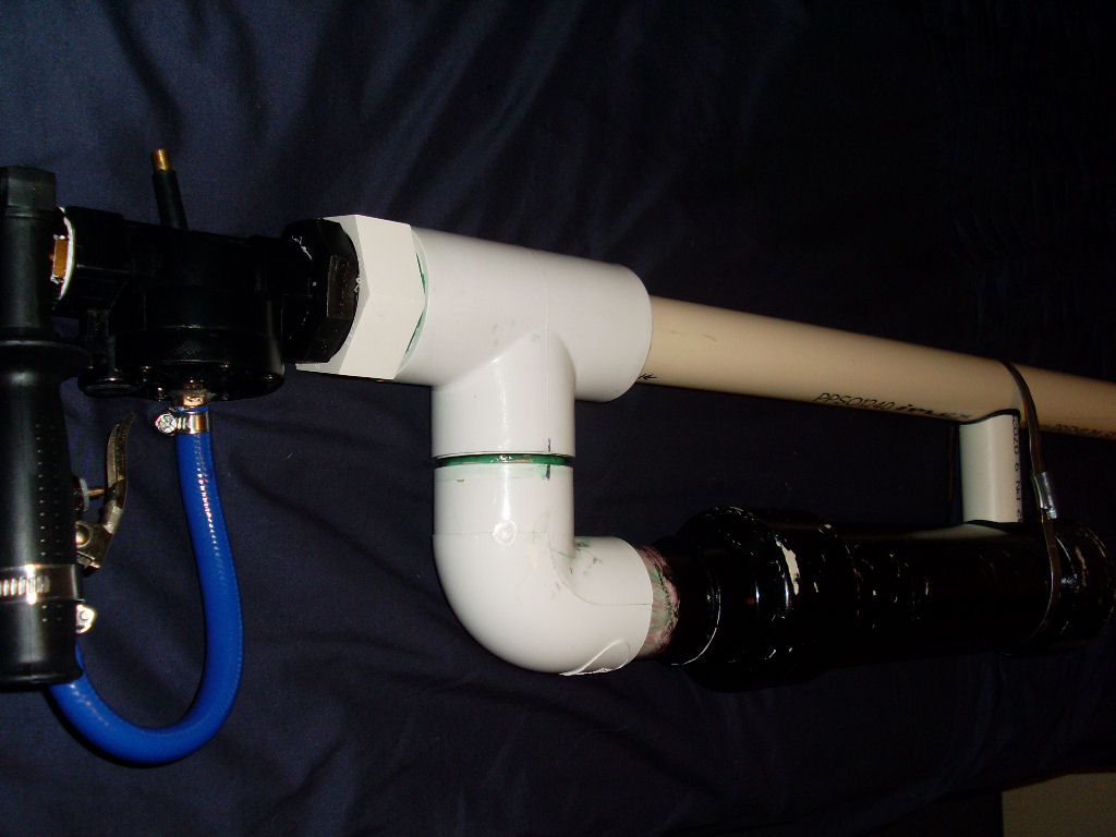

Also the sprinkler is leaking quite a bit from the exhaust side of it, maybe the hose clamps or are slowly leaking and making the diaphragm seal leak, I'm not sure, hopefully the seal is just dirty or something.

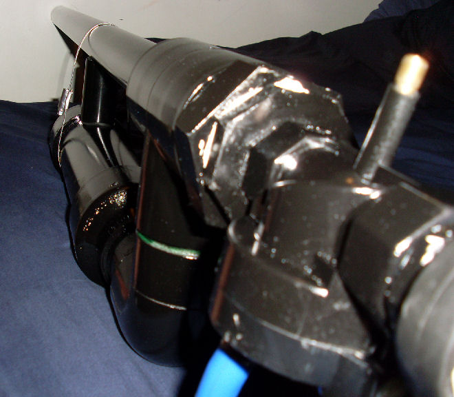

Ok heres what it looks like so far, haven't done the barrel support yet or painted
