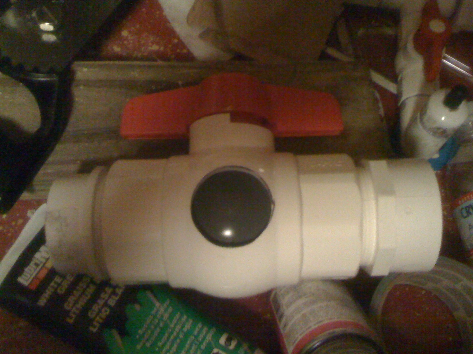

Are you sure that a golf ball will fit in that ball valve? I think the ball of the valve doesn't have a diameter of 1.5 " like the pipe, but im not sure. You might want to look at the breech loader BCarms has.

heh, the only part ive actually made already is that valve. used a 2" ball valve, which is why the 1.5 SDR is inside of it. works perfectly, except its really tough to turn it from the close position. I think i'm going to add an arm on to make it easier once its actually on the gun.
The 1.5" is sleeved in 2" pressure rated on both sides, saftey i guess? even though its supposed to be ok. I've only ever worked with pneumatic and its not fun when they blow up unexpectedly.

Correct Ford, the ball valve does have a smaller hole than the pipe. That will leave you with a little more rethinking...
EDIT:
If the 2" works, but is hard to open, put some vasoling on the ball of the ball valve while it's closed. Then open and close it a few time and it will open as fast as you can turn it.

took some pictures of the valve, ill add them

Nice job lining up the golfball hole with the valve hole...looks perfect from the picture. Did you use a forstner bit and a drill press to drill it?

i used something like a forstner, its ancient though not as spiffy as they are now. but it was a tad small, widened it a little with a dremel
havnt got a drill press though, had to just do it by hand. marked a dot in the center by eye and drilled a pilot, got lucky i guess.
EDIT: looked it up, called a holesaw lol, i actually think its the same one as in the picture on wikipedia

Actually a holesaw may work better for this application. You did a good job with it!JET47 wrote:i used something like a forstner, its ancient though not as spiffy as they are now. but it was a tad small, widened it a little with a dremel

JET47: That mod'd ball valve was beautifully done. The gun looks very good.
